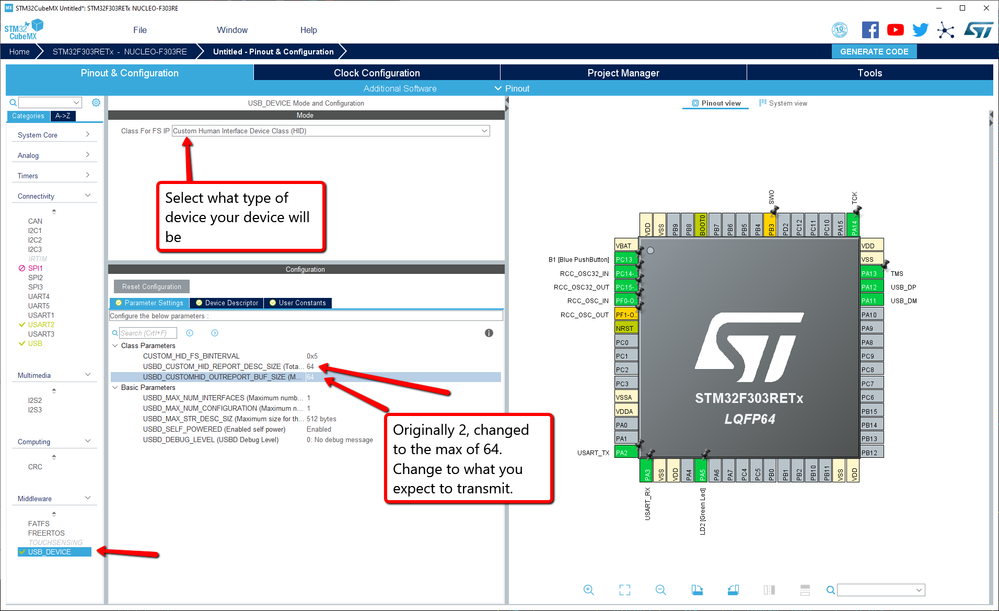

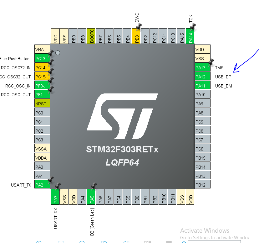

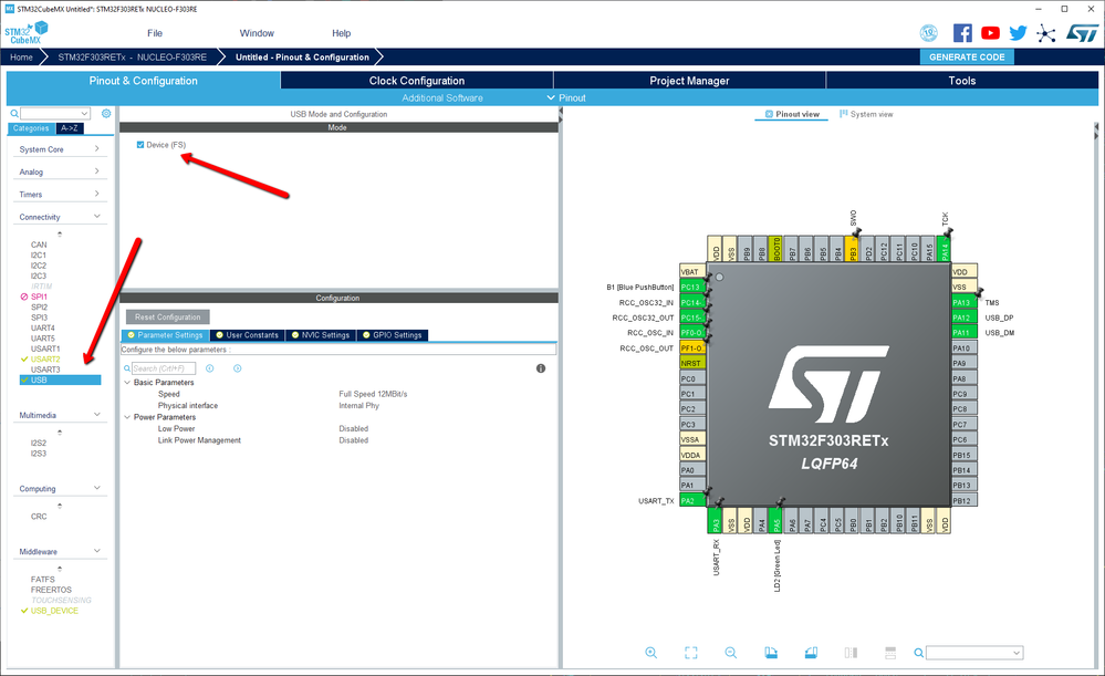

If you are using STM32CubeMX (which I would suggest), did you enable the various USB elements? Take a look at the images.
I created a project in the latest version of STM32CubeMX and attached it. I don't have a F303 to test with so you will have to give it a try.
