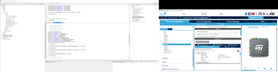

I have updated IDE and MX, and found that the usart buad rate setting is wrong: setting 115200, but actually baud rate is 57600 (half setting). Is it new ST firmware error or not? I am not sure that the other clock settings is right. Please help to check. Thanks.
here is the attached is my usart_test, software.
