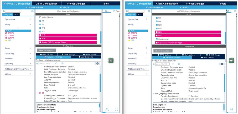

I have tried to load a Project (.ioc file) build with CubeIDE 1.15.0 in the newly released CubeIDE1.16.0 (with CubeMX 6.12.0).
This give me an error on ADC1:
1) I can't select Vbat as ADC source (as working on CubeMX 6.11.0)
2) I get a warning about ADC_Regulare_ConversationMode
The attached picture shows to the left the 1.16.0 and to right the 1.15.0 version
Is this a known problem with the CubeMX 6.12.0?

Thank you so much for reporting this issue. I confirm it on my side and I've escalated it to the Concerned team for correction (under tickets number 186012 and 186009).
Update: this wrong behavior has been solved on the STM32CubeMX V6.13.0.

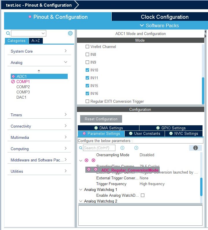

Could you please share your .ioc file and a screenshot of the warning if possible.
Best Regards.
STTwo-32
Hi STTwo-23
Attached a sample .io file made with MX 6.11.0
If You open it with MX 6.12.0 without migration the ADC1 is OK (Vbat is present and there is no error).
If You migrate the file with MX 6.12.0 Vbat is missing and there is a error.

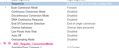

Dear STTwo-32,
The same problem exits for Stm32u073 and u083. Looking for add IN17, need to set the sequencer to not fully configurable and then :
I'm using CubeIDE 1.17, same result on CubeMX 6.13.
