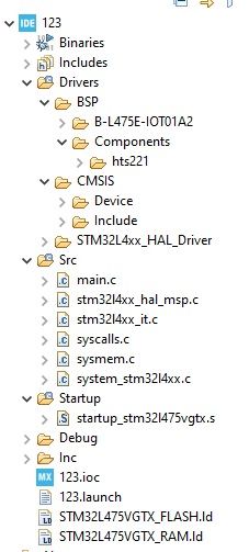

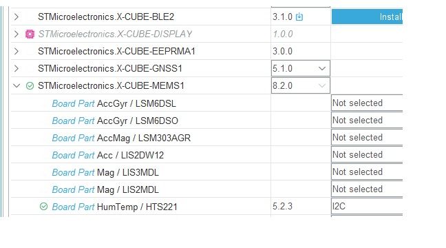

I tried recreating a project with this board (using CubeMX ) and adding one component only from
It created the project with this structure
It builds without any errors. So far so good.

Can someone guide me or show me a procedure to identify the files with their locations and copy them to relevant directory and also paste the codes (with any changes if necessary) so that it will be compatible and will build without errors.
I have tried doing this, but encountered too many errors. I do not want to start debugging as the codes are from a working example for the same board. My understanding is it is more of configuration issue and adding missing driver files. Copying drivers files similar to the example project did not work, I think there is more to that than just copy.
