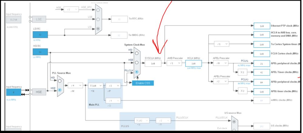

Hello,You are absolutly correct i get stuck in the while loop of delay'and i dont know why
In my delay block the clock is defined as shown in the cubemx APB1 clock is 21MHZ so i putt ARR=21 to make an interrupt every 1MHz,Why its a problem?
i added the toggle line and my HOME scope gave me a result as shon bellow.
Its not very accurate,but we see 1Mhz clock signal.
