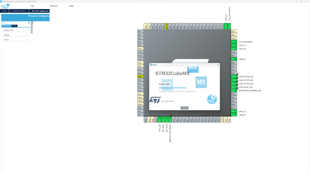

The issue I am having is that CubeMX (latest version from the website) is totally messed up in my desktop PC with windows 10. Everything works fine on my windows 7 laptop.
One picture tells more than a thousand words so here are two.
It's totally unusable. Never seen this kind of behavior with any software I am using in my windows 10 desktop.

Same problem here, 4 years later, lmao.
I7 13700k, RTX 3080 Ti.
Windows 11 Pro, 22H2.
4K resolution, 150% scaling.
32gb ram, ~22gb ram free.
Latest stm32cubemx version.

Hello Kudos, I am using a laptop which uses RTX3060 and 2K display and I got same issue as yours.
I figured out a workaround is set the window -> display size to larger, and then UI glitch issue disappeared.

On windows set environment variable J2D_D3D to false can fix this.
You can use the PowerShell command to do this as
setx J2D_D3D falseIt seems like unappropriated graphical acceleration issue on windows platform which provide by DirectX3D.
