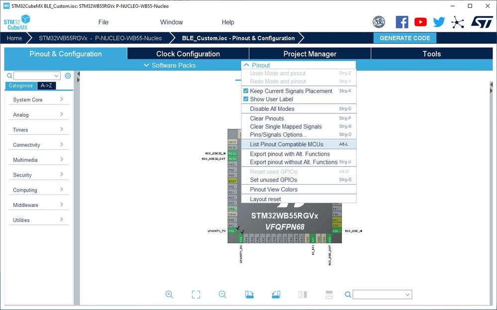

question is a little bit old, but it seems like, there has been a better solution since the last answer.
In STM32CubeMX in the main view you can click under "Pinout & Configuration" on "Pinout" -> "List Pinout Compatible MCUs (Alt-L)".
In the new open window you can now selected a different MCU and import it into your design. You can even change the MCU Series and/or packages. User Pin Labels and Configuration seems to be the same as before.

2023-12-14 5:41 AM - edited 2023-12-14 5:59 AM
I can only select the alternate parts in this dialog when using the embedded CubeMX editor in the IDE, but there is no option to set the selected part.
I got it to work by doing this (but I'm fairly certain that it will ONLY work if the desired part has all of the same peripherals, libraries, etc. and only the FLASH/RAM size is different between your current part and the desired part):
