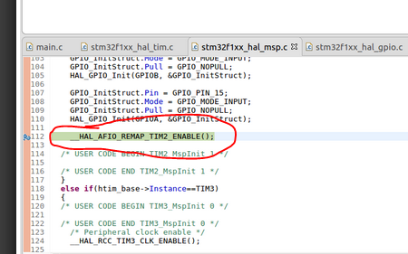

2017-09-19 4:37 AM
thank you for advices.
I can not run callgraph in sw4stm32 - 'Unhandled event loop exception
java.lang.StackOverflowError'. I increase 'Minimum stack size' in
stm32cubemx 2 times to 0x800. No effect.
I attached screens for 'Step Into'. Debugging hangs in line 112
stm32f1xx_hal_msp.c __HAL_AFIO_REMAP_TIM2_ENABLE();
Regards,
Boris.

________________ Attachments : F5_before_hang.png : https://st--c.eu10.content.force.com/sfc/dist/version/download/?oid=00Db0000000YtG6&ids=0680X000006HyRW&d=%2Fa%2F0X0000000b7g%2FRGAC_baRLqlSUFBnIS6HLeypLgw3W3yZFJv24xysckU&asPdf=falseF5_hang.png : https://st--c.eu10.content.force.com/sfc/dist/version/download/?oid=00Db0000000YtG6&ids=0680X000006Hy8D&d=%2Fa%2F0X0000000b7e%2FmibobpCb4hLB4SZmqa25kvNpHLGOtK0p8eaaNj7ka.c&asPdf=false2017-09-19 6:52 AM

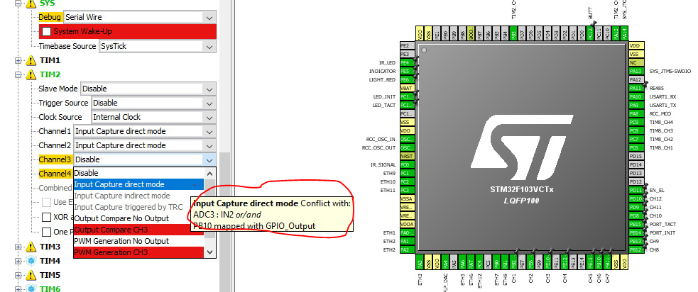

I can't understand how this code generated.
__HAL_AFIO_REMAP_TIM2_ENABLE() is a full TIM2 Remap (remaped to B11, B10, B3, A15 pins)
But according to your IOC file you can't sellect PB11, PB10 because are reserved as GPIO outputs.
I use an updated version of CubeMx 4.22.1

2017-09-19 9:55 AM
Excuse me,
I have sent a wrong ioc and code. Correct ones are attached.
Regards, Boris.
