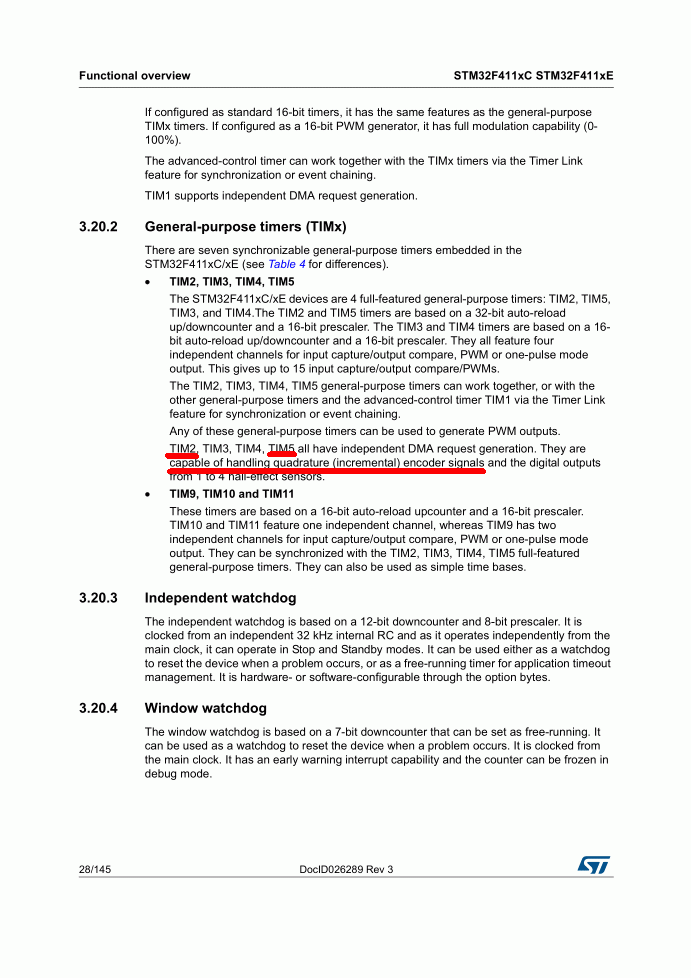

Or, use TIM2 or TIM5, they are 32-bit counters.
Done, easier and faster! ;)

I need to check it. I was thinking that only one 32bit counter supports encoder on F411.

I was thinking that only one 32bit counter supports encoder on F411.Maybe. You didn't ask for more and I didn't check.
2017-03-27 7:47 AM
Yes, you are right with 32bit counters. Because of that, I'm thinking about moving to F7 with two 32bit counters handling Encoder.
But my intention was to find a way to easily count pulses above counter capability. I was thinking that interruption approach would be the simplest way and efficient one. There are only a few 32bit counters on a microprocessor. So this could be limiting.
