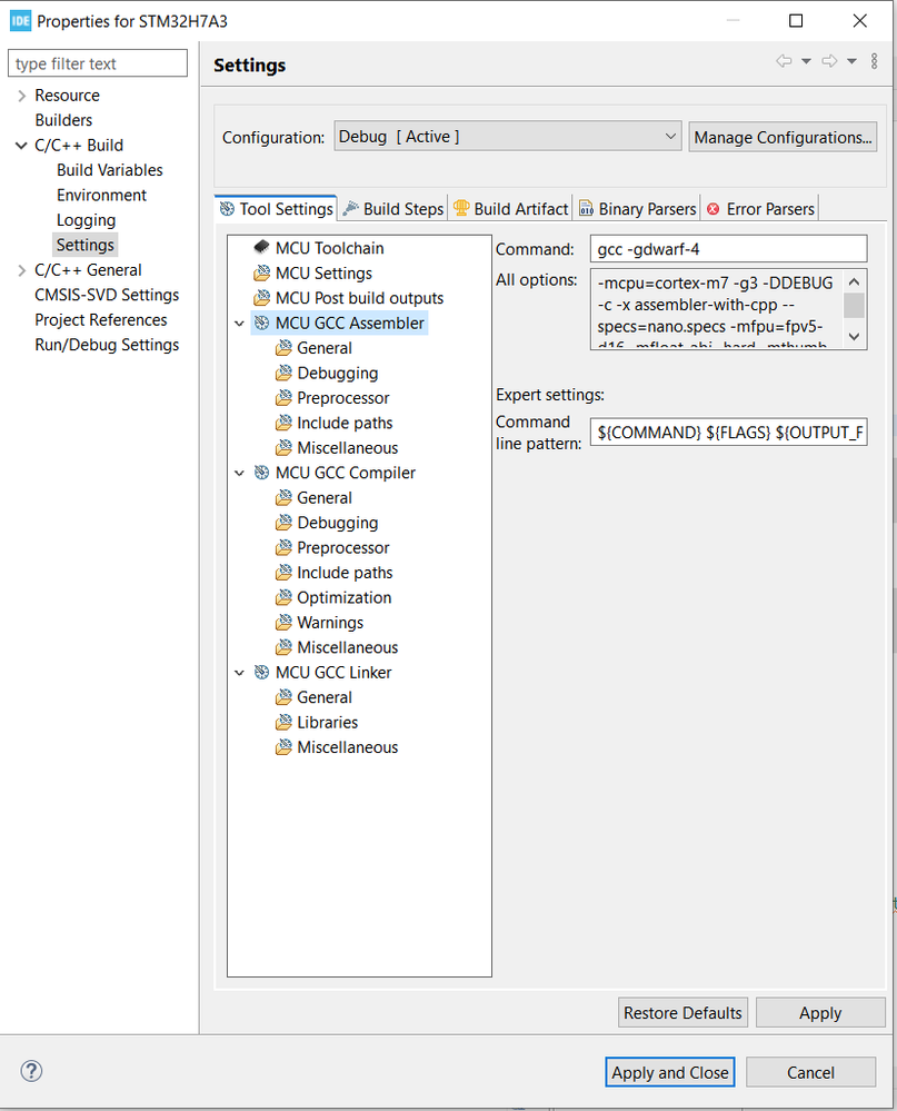

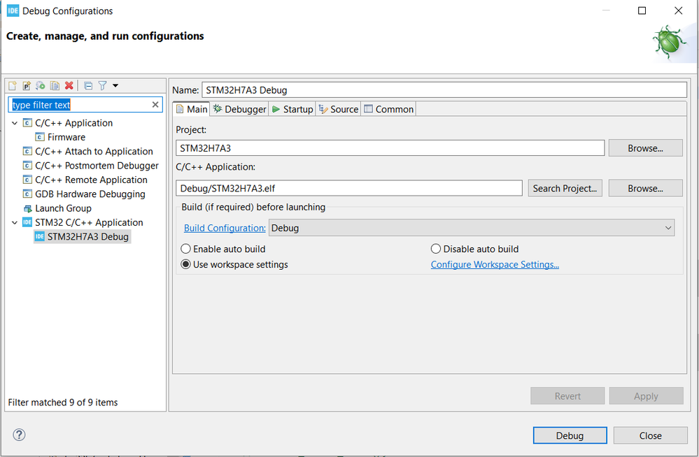

I am currently using the STM32H7A3VGT6 along with STM32 Cube IDE for debugging. My code starts properly in debug mode, but when I power cycle the device without the ST link connected, it sometimes executes and sometimes does not. I have turned ON three LEDs in the MX_GPIO_Init() function, but they do not light up when the code execution fails.
To address this, I adjusted the optimization level from -Og (debug) to O1 (level-1), and the code ran as expected without the debugger. However, after a while, the code stopped executing at optimization level O1, prompting me to revert to -Og for it to work properly again.
I have attached the project settings, debug settings, and code initialization for your reference.

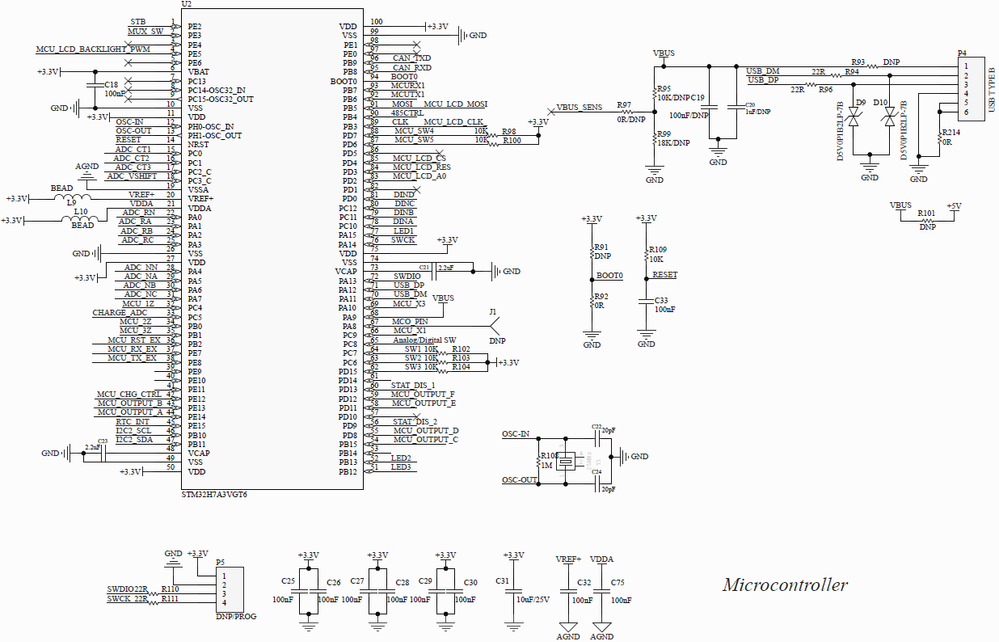

Please post the schematic
2024-10-10 4:15 AM
Please note that this behavior is occurring across all boards.
Schematic attached.
