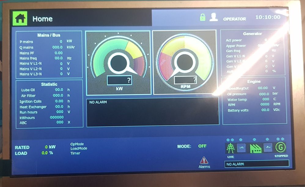

here is one of my latest experiment with Google Nexus 7 inch display with 1280x800 resolution.
The first screen is connected with ComAp's Inteli-compact NT over modbus RTU and my screen has more then 30 parameters , updating in real time. also the icons are changing colors as I programmed.
