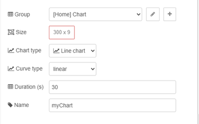

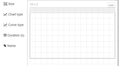

- clicking once on the 'size' menu gives me this table-generator lookalike grid,
on which when i try to go any further than 15 in terms of horizontal size just closes on me:
- double clicking on n x m chart size gives me this configuration window:
on which no matter what i put in for the horizontal size (tried 16, 30, 300...),
the chart I get when I deploy the dashboard seems to have a fixed horizontal size of 15.
