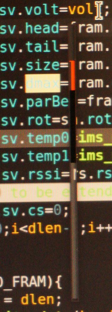

Hi Markus, made a camera screenshot bcs on Linux the context window opening on mouse-over disappears when invoking a screnshot.
You can see a small vertical window which seems to contain something; hitting it with the mouse a double-arrow appears as for to change its size - but cannot be done. ... trying to upload the image ...
2021-11-22 10:29 AM
2021-11-22 10:35 AM
don't know why there are two pictures - I inserted only one. The cursor is over the variable 'volt' and a very narrow but vertically well sized window appears. Usually it contains the value(s) and other information of the variable. It might have been that I accidentally minimized the width of this window to 0 maybe using the trackpad (which tends to do nasty things) and now cannot enlarge it again.
Now I am looking for an file containing setting information on this parameter to change it manually. Maybe it is also valuable to limit this variable to avoid this error in future versions of the software. Thanks for your efforts.
