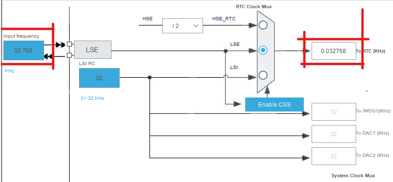

LSE osilator source wrong seems. I set 32.768kHz but that it seems 0.032768kHz

I could not confirm the problem with my samples, it was always correctly specified 32 for the RTC (OK, this is also not absolutely correct, but every programmer knows what is meant).
It would be helpful if you would give additional information, e.g. version of CubeMX or CubeIDE, type of the STM32.

2022-03-25 4:09 AM
Hi @Peter BENSCH
MCU: STM32H7B3IIT6
IDE: STM32CubeIDE Version: 1.9.0
2022-03-25 4:31 AM
OK, I can confirm this issue, thanks for reporting it.
@Khouloud OTHMAN Please check this with the CubeMX team so that they correct this unsightliness?

Hello @Community member ,
Thanks for your feedback,
Issue confirmed from my side and I reported it to the dev team to be fixed. I will keep you posted with the updates.
Internal ticket number: 125200 (This is an internal tracking number and is not accessible or usable by customers).
This issue is fixed in STM32CubeMX latest release.
V6.6.0 is now available under this Link.
