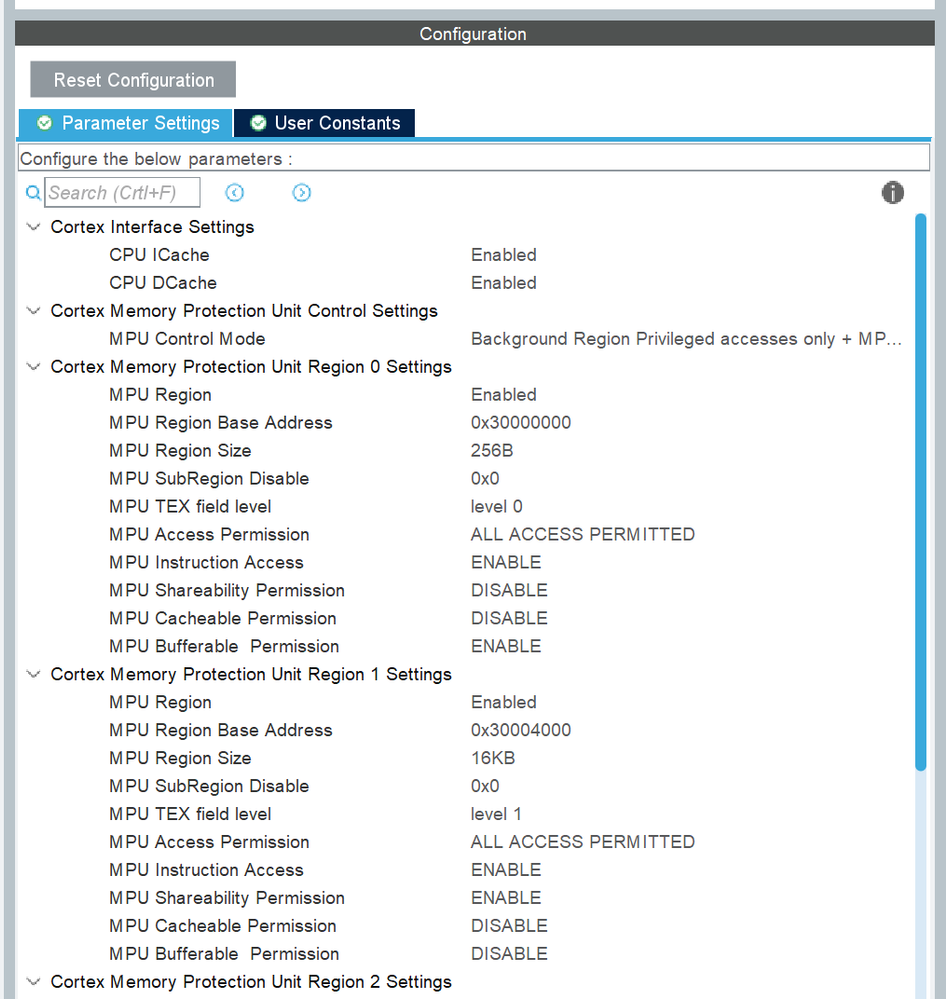

I am using CubeIDE Version: 1.6.0 Build: 9614_20210223_1703 (UTC) to initialise the MPU as it is done for the TCP_Echoserver, however the LL resulting code does not set the LL_MPU_TEX_LEVEL1 bit for the second region
Generated code:
/* MPU Configuration */
void MPU_Config(void)
/* Disables the MPU */
LL_MPU_Disable();
/** Initializes and configures the Region and the memory to be protected
LL_MPU_ConfigRegion(LL_MPU_REGION_NUMBER0, 0x0, 0x30000000, LL_MPU_REGION_SIZE_256B|LL_MPU_REGION_FULL_ACCESS|LL_MPU_INSTRUCTION_ACCESS_ENABLE|LL_MPU_ACCESS_NOT_SHAREABLE|LL_MPU_ACCESS_NOT_CACHEABLE|LL_MPU_ACCESS_BUFFERABLE);
LL_MPU_EnableRegion(LL_MPU_REGION_NUMBER0);
LL_MPU_ConfigRegion(LL_MPU_REGION_NUMBER1, 0x0, 0x30004000, LL_MPU_REGION_SIZE_16KB|LL_MPU_REGION_FULL_ACCESS|LL_MPU_INSTRUCTION_ACCESS_ENABLE|LL_MPU_ACCESS_SHAREABLE|LL_MPU_ACCESS_NOT_CACHEABLE|LL_MPU_ACCESS_NOT_BUFFERABLE);
LL_MPU_EnableRegion(LL_MPU_REGION_NUMBER1);
/* Enables the MPU */
LL_MPU_Enable(LL_MPU_CTRL_PRIVILEGED_DEFAULT);

Hi @Community member ,
Thanks for your feedback. I've been able to reproduce the issue from my side and I will report it internally to be reviewed by the development team.
I will keep you posted with updates.
Even though this reply doesn’t directly solve the issue, I’m marking it as Best, since it will help clarify the current situation for other customers with the same question. I will post an update here once the issue has been fixed
Thanks for your contribution.
Khouloud.

2022-06-29 3:09 AM
This issue is fixed in STM32CubeMX latest release.
V6.6.0 is now available under this Link.
