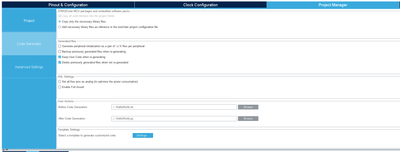

What I have to do that I can directly call some python scripts as pre/post code generation step with CubeMX 6.14.1 under Linux?
Currently I can execute directly the python script on a Windows Machine, but on the Linux machine nothing happens. On Linux I can execute the scripts directly from command line without CubeMX and I can execute the scripts over a bash script which is calling the python script.
  • Do I need to configure anything additional?
  • Is there a possibility to select which python version is used?
  • Any other hint where my problem could be?
Thanks in advance

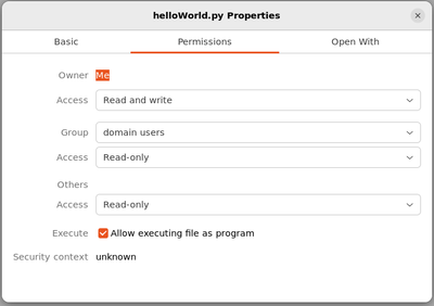

does your script contain a proper shebang?
has it the executable flag set?
If so and it doesn't work, wrap it in a shell script.

Does it work if you use "python ../../helloWorld.py"?
I tried different shebang's and I set also executable flag (See printscreens)
nobody
Associate II
Unfortunately it does not work with python before the path. Without python cubeMX does not complain, but it is not executed.
