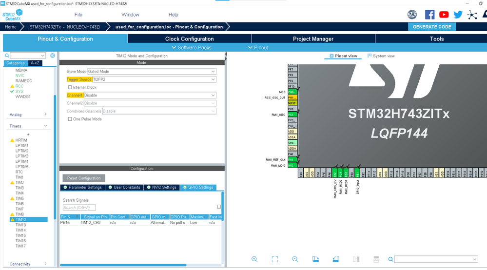

In CubeMX, the default pin that is set to TIM12_CH2 is PB15 but it is possible to change it to PH9. Please check this article on How to remap an alternate function from one GPIO to another using STM32CubeMX
Saying that PB15 is reserved for another signal, in this case CubeMX will automatically use PH9.

As @MM..1 and @TDK mentioned, both pins support TIM12_CH2 signal. So using PH9 or PB15 for TIM2_CH2 is correct.
