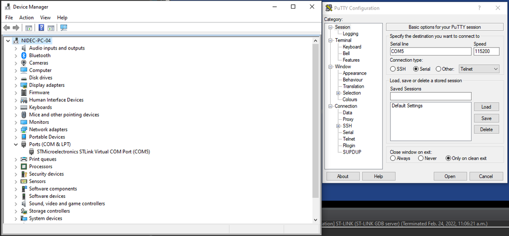

I have no console output for UART;
I am using STM32F429ZI dev-kit CubeMX and STM32CubeIDE
The codes compiles and I can see the light blinking but when I connect to Serial terminal with PuttY, I observe no console output.
What am I missing ?

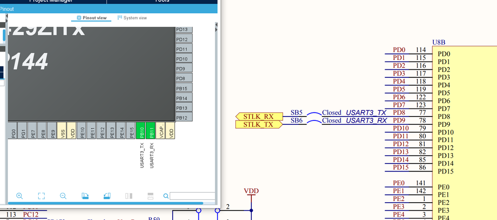

I was able to set up UART5 and observe the bit stream on oscilloscope on PC12 but as I can see on Schematic, the signal doesnt get routed to ST-Link.
PA2 & PA3 are routed to ST-Link (UART2) but no signal on Oscilloscope for PA2 (Tx Pin)
Are you talking about the NUCLEO-F429ZI board, or the DISCOVERY one?
Check you're enabling the right clocks.
Check you're enabling the right pins, with the right AF setting for USART2
Should be in the MSP file
On the NUCLEO-F429ZI, the ST-LINK VCP is connected to USART3 via PD8/PD9, isn't it?
https://www.st.com/resource/en/user_manual/um1974-stm32-nucleo144-boards-mb1137-stmicroelectronics.pdf
Why? Schematic and user manual are consistent. You need to change the pin assignment to PD8/PD9 by clicking on the new pin and selecting the USART3 function.
Or you picked the wrong pins?
USART3 has multiple pin muxing options, check STM32F429ZI data sheet, it has lists and tables..
