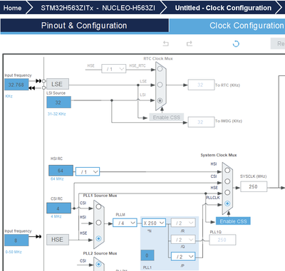

Ok, fair enough, perhaps the principle is that the default CubeMX configuration is similar to how the MCU is configured at startup (or by SystemInit() where CubeMX also generates some clock setup).
For Nucleo-H563ZI, CubeMX does in fact do something different: it sets up 250MHz from HSE (connected to ST-Link I think).
