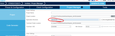

2025-12-01 5:38 PM - edited 2025-12-01 5:44 PM
Hi @TDK,
Do you know how I can toggle between "Advanced" and "Basic" application structure? In my CubeMX, that option is unhigh-lighted and I can't change from "Advanced" to "Basic".
2025-12-01 5:55 PM
After you generate code, it is locked and can no longer be changed to avoid user code and other files being deleted unintentionally.
To change it, do a Save As on the IOC and it will be available again or manually edit the IOC file. Back up your files first--switching mid-project is not a supported use case.
