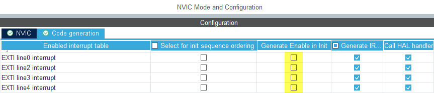

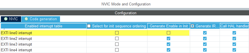

When attempting to initialize a single GPIO EXTI as disabled, the generated code still enables the interrupt. I did notice that if I uncheck all of the EXTI lines, then none of them are enabled in the generated code. So it seems it's all or nothing. Is this the expected behavior?
Thanks,
Frank
This:
Generates:
/* EXTI interrupt init*/
HAL_NVIC_SetPriority(EXTI0_IRQn, 5, 0);
HAL_NVIC_EnableIRQ(EXTI0_IRQn);
HAL_NVIC_SetPriority(EXTI2_IRQn, 6, 0);
HAL_NVIC_EnableIRQ(EXTI2_IRQn);
HAL_NVIC_SetPriority(EXTI3_IRQn, 6, 0);
HAL_NVIC_EnableIRQ(EXTI3_IRQn);
HAL_NVIC_SetPriority(EXTI4_IRQn, 6, 0);
HAL_NVIC_EnableIRQ(EXTI4_IRQn);However, this:
Generates:
