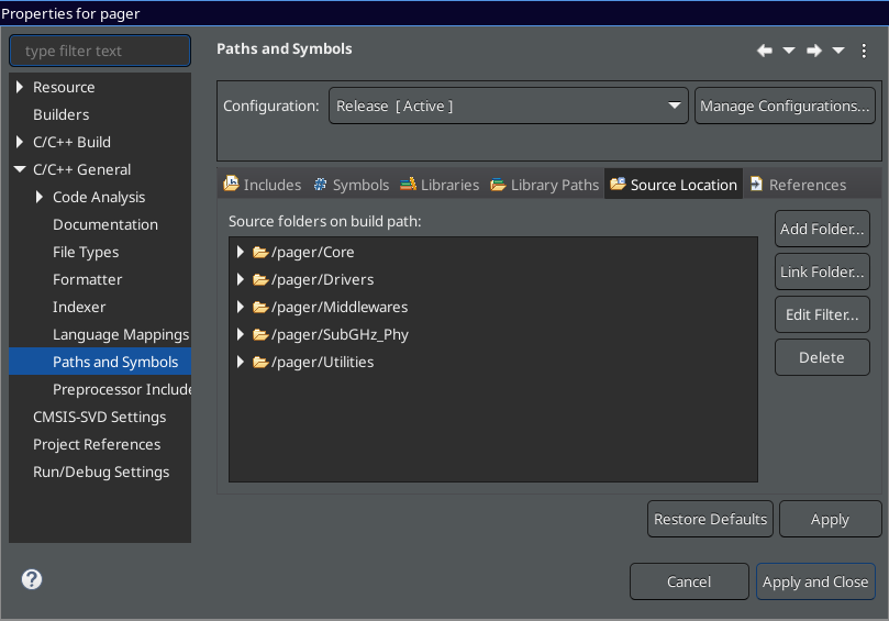

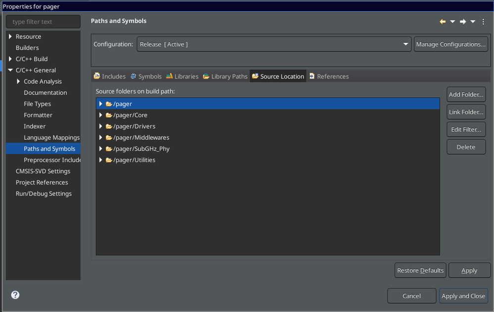

Okay... able to reliably reproduce this every time.  I didn't do anything other than generate.  It may be an issue with using the root project folder as a "Source Location"

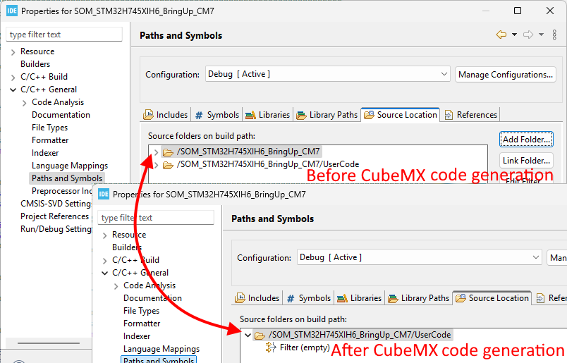

BEFORE:
AFTER:
