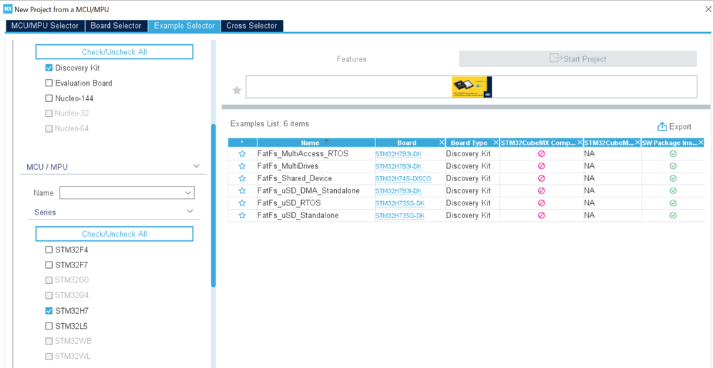

Example selector allows you also to browse a large set of examples and to start a new project from a selected example:

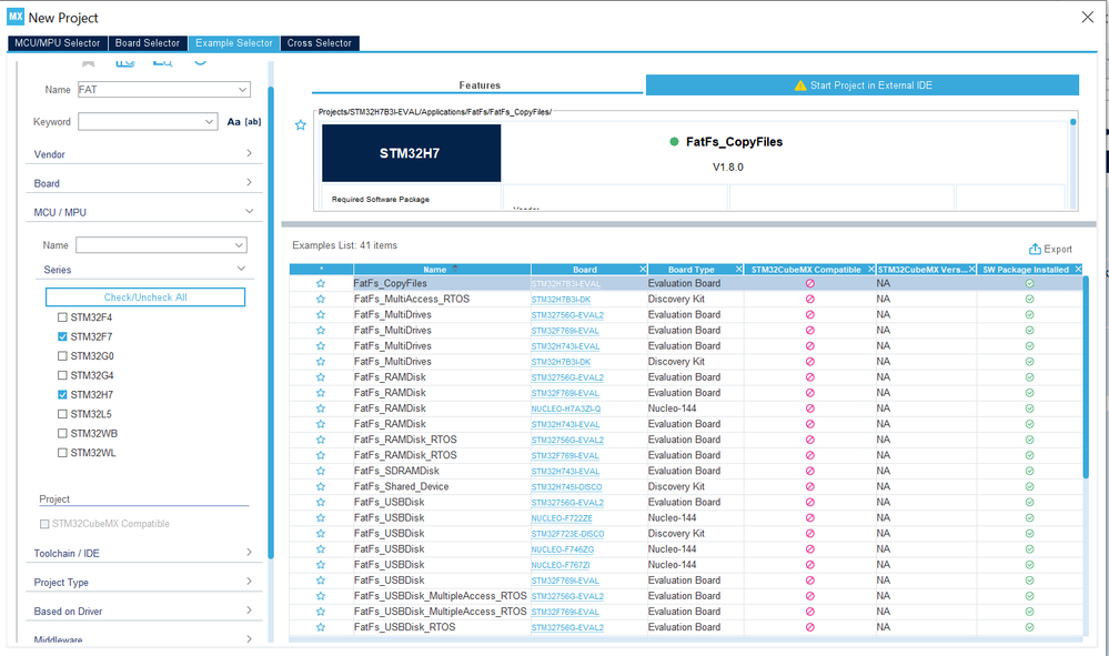

As I indicated above, through the Example selector, you can browse a large set of examples and thanks to the filter panel it is possible to filter down the example list:

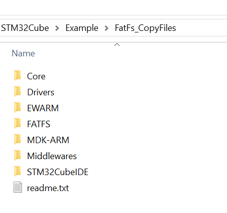

Taking FatFs_CopyFiles project for example: Which is an application describing how to use STM32Cube firmware with FatFs middleware component as a generic
FAT file system module. This example develops an application that exploits FatFs features to configure two microSD drives and copy files from the first instance to the second.
Opening the project folder :

Would the FatFs_uSD_Standalone example allow me to load files via uSD card port?. This runs on the cheaper STM32H735G-DK board so would be better.
