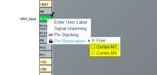

NB: For pins which are assigned on pinout view (as the case of GPIO_input..) and when the MCU used is a dual core, you need to reserve one cortex for that pin (see image below) to be then generated.
