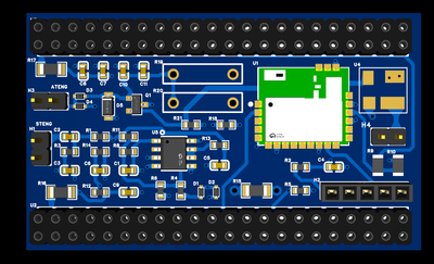

The hardware circuit is as follows:

1 REPLY 1
dzf
Associate II
my PCB layout is as following, does it led to the above question?
