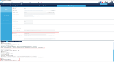

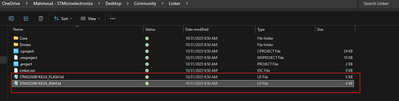

Hello @JimBlankenship ,
The behavior described was not reproduced by my side. By creating a project with STM32G0B1KEU6 and importing STM32G0B1KBU6 settings, STM32G0B1KEUX_FLASH.ld and STM32G0B1KEUX_RAM.ld are generated.
Could you provide the Ioc.File with which you are experiencing problems?
