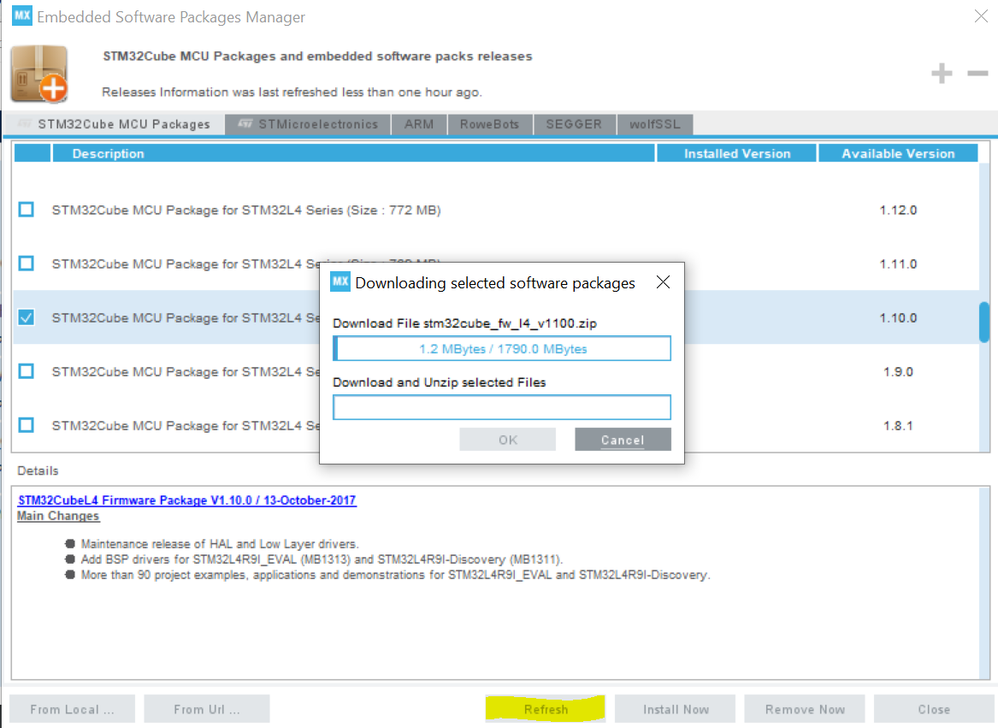

I am using CubeMX v6.2.1, when I attempt to install the L4 MCU package v1.10.0, I get an "HTTP Access Forbidden" error. I am seeing the same error on Windows and Linux.
I can download v1.9.0 and v1.11.0, and v1.17.0 without issue. The error only seems to happen with v1.10.0.
I am attempting to update a project from v1.8.0, however, the CAN API changed in v1.11.0, so wanted to upgrade to v1.10.0 as the most recent update prior to the CAN API change.

2021-06-16 12:51 PM
Thanks for the response. I have tried refreshing before attempting to download.
I actually wound up running Wireshark to capture my network traffic to see the actual low-level HTTP request and response, you can see the low-level HTTP in my original message (I've also copied it below:
