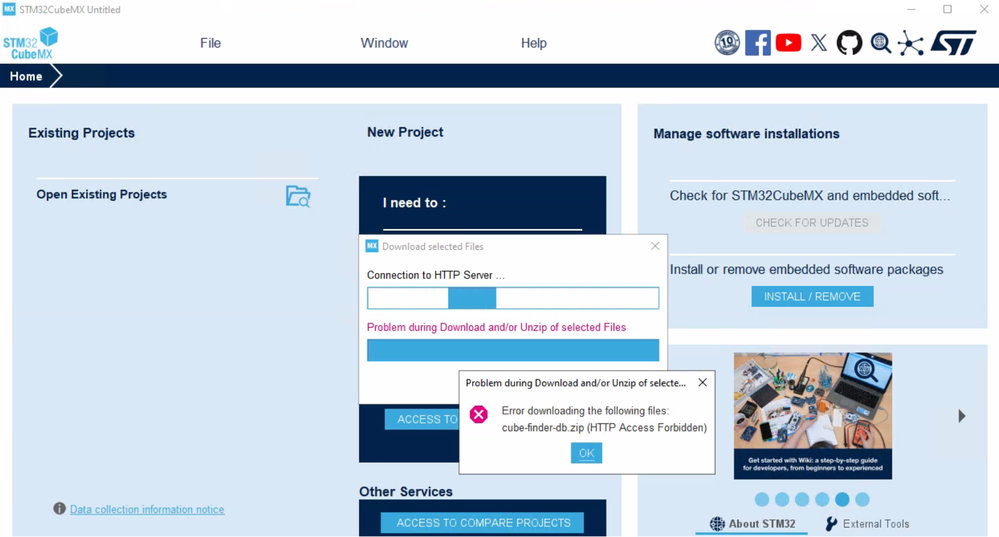

While using STM32CubeMX, I encountered an error when attempting to select "Refresh Data" (via Help > Refresh Data) or "ACCESS TO MCU Selector". The error message displayed is: cube-finder-db.zip (HTTP Access Forbidden). The screenshot of the error message is also attached.

Thank you for your prompt response.
I have followed the suggested solution; however, the issue persists.
To provide additional context regarding the problem encountered on my system:
I am operating behind a firewall that requires all URLs to be explicitly whitelisted for internet access.
I have ensured that both HTTP and HTTPS access to st.com and its subdomains are enabled, yet the requests are still not being processed successfully.
If there are any additional domains that must be whitelisted to facilitate proper access, I would appreciate it if you could share those details.
I would be grateful for your continued assistance in resolving this matter.
