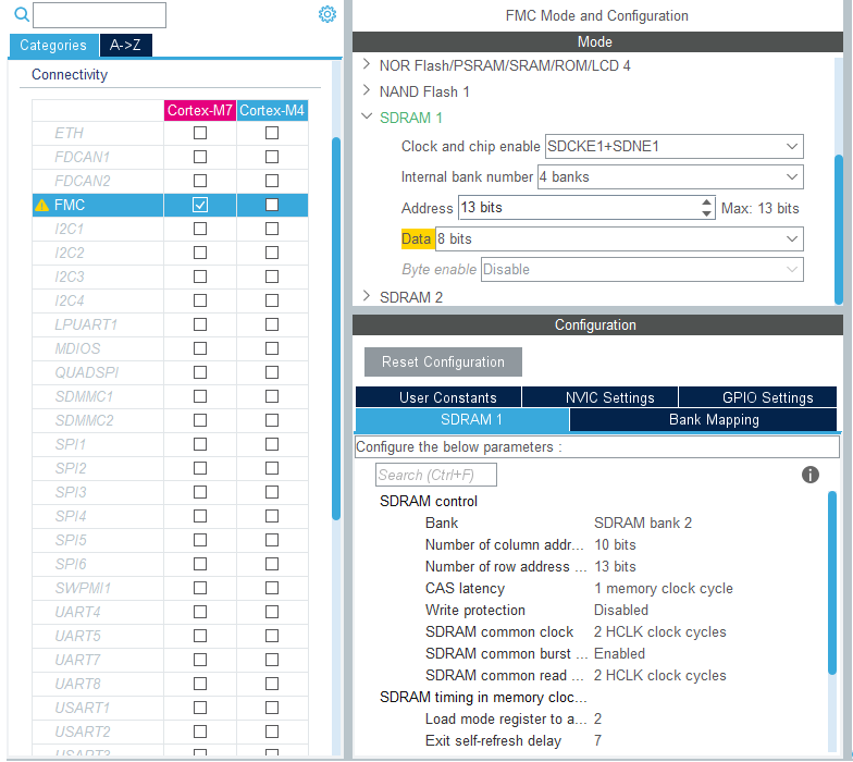

I am test external SDRAM with STM32H747.
SDRAM chip is IS42S8640D-7TLI
I set SDRAM1 in FMC of Connectivity as followed
Clock and chip enable : SDCKE1+SDNE1
internal bank number : 4 banks
Address 13bits
DAta 8 bits
number of column address bits : 10 bits
number of row address bits : 13 bits
After I generate code,
'SystemInit_ExtMemCtl(void)' is not in sytem_stm32h7xx_dualcore_boot_cm4_cm7.c
The function is not anywhere.
Other example project for SDRAM has the function
What should i do more?

After compiling, in debug mode
when excute memcpy((uint32_t *) SDRAM_ADD, wdata, 5);
It occurs Hard fault.
Could anyone let me know how to set external SDRAM and fix my mistakes?

It appears that there is an issue with the way you are trying to access the external SDRAM. The 'memcpy' function is used to copy data from one memory location to another, but it is not designed to initialize or configure the SDRAM. The 'memcpy' function is also assuming that the memory location is valid and accessible, which may not be the case for the external SDRAM.
In order to properly initialize and configure the external SDRAM, you will need to use the appropriate functions provided by the STM32H747 firmware library.
The 'SystemInit_ExtMemCtl(void)' function that you mentioned in your previous question is typically used for this purpose.
So try to add this function manually in your code .
You should also check the SDRAM's data sheet and the STM32H747's reference manual for more information about how to properly configure the SDRAM.
The SDRAM's data sheet will provide information about the timings and commands required to initialize the SDRAM and the reference manual will give you information about the registers and functions that are needed to configure the SDRAM.
It's also important to check the memory address you are writing to, as it may not be in the correct range.
Additionally, you should check the SDRAM's datasheet to ensure that you are providing the correct timing parameters,
such as the load mode register to active delay and the exit self-refresh delay. If the values you have set do not match the specifications in the datasheet, it could cause issues when trying to access the SDRAM.
In summary, it is important to use the correct initialization function ,
consult the SDRAM's datasheet and the microcontroller's reference manual and make sure that the memory address is correct and the timings are set correctly.
