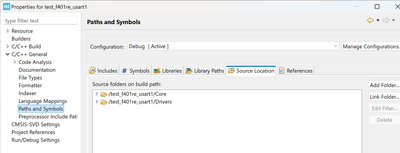

Are all *.c files within directories marked as Source Locations?
There is no GCC-equivalent for the "__attribute__((at(0XC01F4000)))" attribute. You can define a new section in the linker and place them in that section.

As @TDK said, this suggests that not all your files are being compiled.
You can see what's being compiled in the build console window ...
