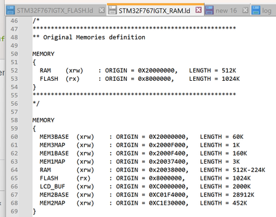

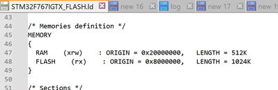

2025-10-11 9:32 PM
Still think you're modifying one linker script but using another.
From your screenshot, it looks like you're using the *_FLASH.ld linker script file:
which, from your attached project, only has the RAM and FLASH sections defined.
Looks like you've modified the *_RAM.ld file, but aren't using it:
Delete the linker script you aren't using so the system can't use it.

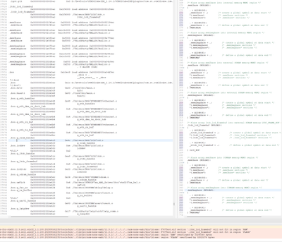

2025-10-11 9:32 AM
Look in the map file to see what is taking up so much space.
Probably the mem2mapbase section needs to be marked as NOLOAD.

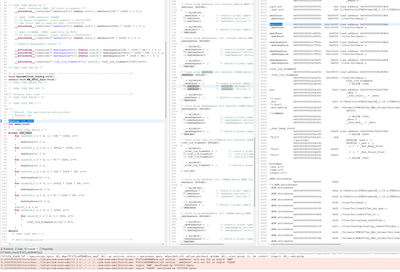

2025-10-11 9:12 PM
I created a very simple F767 project, specificly for this test.
The project only enabled Serial Wire, selected LSE and HSE, added all variables with __attribute__ declaration in the main.c, also initialized these variables in the main, modified linker script as in previous project, and finally build the project, and the build failed:
I found, if I don't do the initializations on these variables by commenting out the USE_VARS definition, the build is okay. Please find attached file for the whole project.

2025-10-11 9:32 PM
2025-10-12 5:41 AM
You are absolutely right!!!
I was not aware of that. I thought the compiler would use the both!
Now it builds ok.
Thank you so ...... much, really appreciate it!
