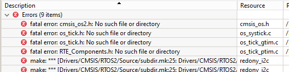

I'm a beginner, and I try to use STM32F103C8 IC for very simple thing.
I updated Ide and MX program to CubeIde 1.12 and CubeMx 6.8. Now I can not Build my project.
There are many error messages which you can see in the picture.
If I see the Drivers tree, the RTOS2 is marked red icon.
1.) I don't understand the CubeMX why generated DSP, RTOS, RTOS2 etc. parts if I didn't ask for them.
2.) How to turn off the generation of these (DSP, RTOS, RTOS2, etc.)?
3.) What else needs to be installed on my machine so that the build process works properly?
Just as an example, I have included a picture of a previous generated C code produced by CubeMx 6.7 and CubeIde 1.11. You can see how much simpler the structure was.
Best regards
Zoltan

Looks like we have the solution.
If CubeMx version 6.8 creates the project and the main code, then the RTOS2 part will be included. I think this is a malfunction.
If we create the new project in the CubeIde program and simply import the previous ioc file, CubeIde already generates the src code correctly and the build project runs without errors.

2023-04-16 8:10 AM
Dear Ghofrane,
I experienced a malfunction in the following case:
a.) I installed CubeMx version 6.8 with default settings.
b.) I made a simple setup for the BluePill module. For example: crystal oscillator, SW debug, Timer3 PWM setting without IT.
c.) I saved the project in the CubeMx application and generated the C code.
The C code and project contained components that CubeIde could no longer translate or link.
I hope that the individual steps can be followed, and that the error phenomenon
Best regards
Zoltán
