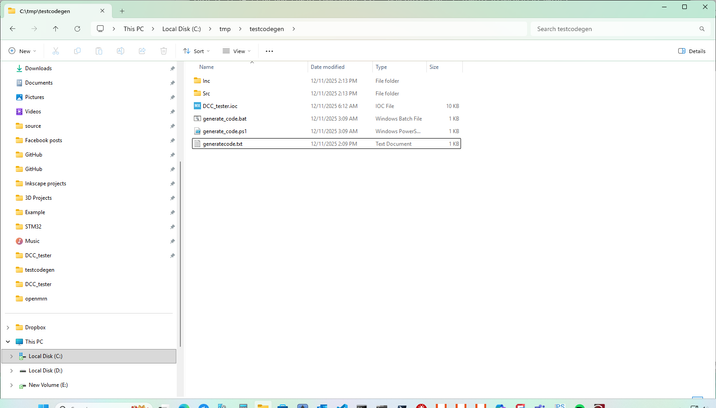

I can click on the .ioc file from Windows Explorer and the MX IDE opens just fine. I can click the "GENERATE CODE" button and that also works just fine. All the files are generated as expected.
I try launching using the -q using ether a PowerShell script or a command line batch file and neither completes although it looks like its trying. Seems to stall leaving a MXTmpFiles folder. cmake and other files like startup and linker file are not generated.
I have attached the .ioc the script text file as well as PowerShell and batch file ... none work as expected.

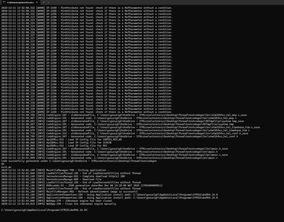

Example
config load "C:\Users\gsourigh\OneDrive - STMicroelectronics\Desktop\Thread\testcodegen\DCC_tester.ioc"
generate code "C:\Users\gsourigh\OneDrive - STMicroelectronics\Desktop\Thread\testcodegen"
exit_mx
Then launch the following command after cd the installation path of MX6.16.0
jre\bin\java -jar .\STM32CubeMX.exe -q "script path"
example
jre\bin\java -jar .\STM32CubeMX.exe -q "C:\Users\gsourigh\OneDrive - STMicroelectronics\Desktop\Thread\testcodegen\generatecode.txt"
As you can see , the code will be generated successfully.

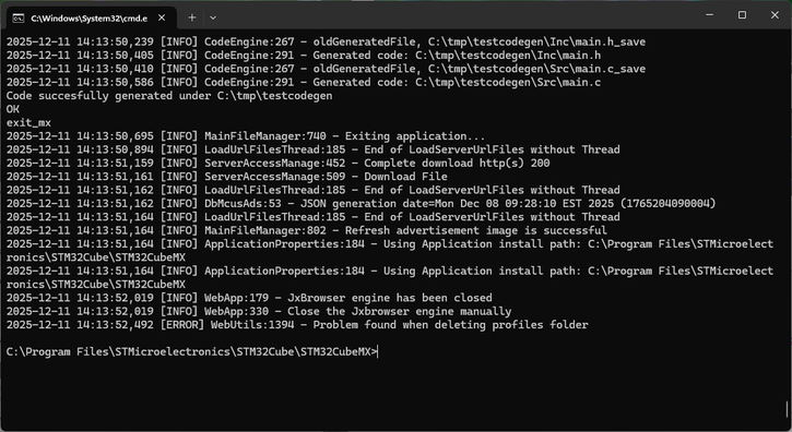

2025-12-11 11:40 AM
looks like you have cubemx installed in a different location. I have mine at:
C:\Program Files\STMicroelectronics\STM32Cube\STM32CubeMX\STM32CubeMX.exe
which is Windows standard location for everyone.
I have ioc and script in my c:/tmp/testcodegen
generatecode.txt now looks like:
config load C:\tmp\testcodegen\DCC_tester.ioc
generate code C:\tmp\testcodegen
exit_mx
launched by cd to
C:\Program Files\STMicroelectronics\STM32Cube\STM32CubeMX>
then
C:\Program Files\STMicroelectronics\STM32Cube\STM32CubeMX>jre\bin\java -jar .\STM32CubeMX.exe -q "C:\tmp\testcodegen\generatecode.txt"
Tried again using my correct full paths and I get some source code generated but not cmake, linker startup etc.
you can src and inc folders and files created within but NO cmake, linker, or start up files.

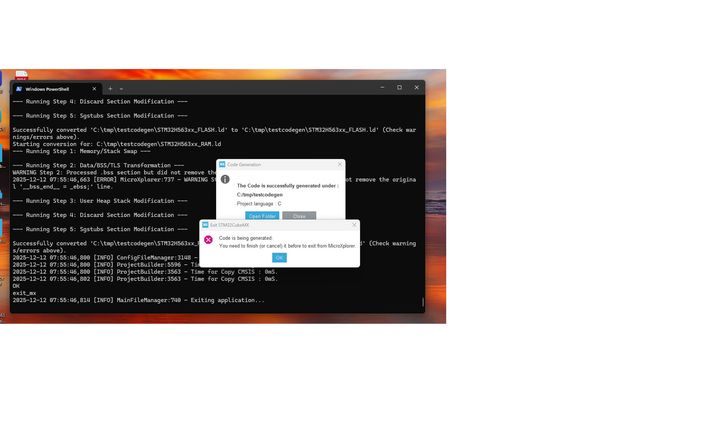

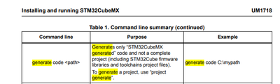

Hello @dvescovi
In your script , let's try to use "project generate" instead of "generate code"
THX
Ghofrane
2025-12-12 5:05 AM
2025-12-12 6:40 AM - edited 2025-12-12 6:42 AM
Hello @dvescovi
Just use "exit" instead of "exit_mx"
Please remember to mark the reply that helped you as the Best Answer so that other users can more easily find this solution.
THX
Ghofrane
