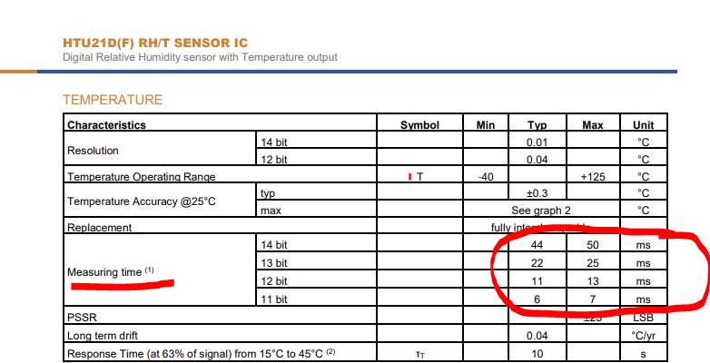

This table indicates how long you have to wait before you can read the temperature data
So...
For doing a soft reset you can use HAL_I2C_Master_Transmit, not HAL_I2C_Mem_Write because you're just writing a register value and not data value.
As for reading the temperature, you need to use HAL_I2C_Master_Transmit to send 0xE3, pause for the given conversion time or check HAL_I2C_GetState. The HTU21D will release the SCK line after the conversion is done. Then you can call HAL_I2C_Master_Receive to read 3 bytes (2 data bytes + checksum) from the temperature register..

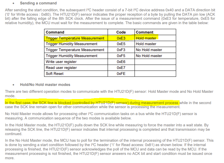

@Anıl Koluaçık From the datasheet, this device has two I2C modes: with SCK stretching (so called "hold") and without (called "no hold"). Usually for STM32 as master, you want the "no hold" mode.
In that mode, the device won't respond to commands until the measurement is ready.
This allows working with other devices on same bus while HTU21D is busy with measurements.
So you can just try reading periodically until read succeeds (or call HAL_I2C_IsDeviceReady until success, then read).

uint8_t cmd[] = {TEMP_MEASUREMENT};
uint16_t raw_temp;
HAL_StatusTypeDef is_ready = HAL_I2C_IsDeviceReady(&hi2c2, (DEVICE_ADDRESS << 1), 10, 100); // returns HAL_OK
HAL_StatusTypeDef res = HAL_I2C_Master_Transmit(&hi2c2, (DEVICE_ADDRESS << 1), cmd, 1, 100);
HAL_Delay(100); // I tried different values

if (res == HAL_OK)
res = HAL_I2C_Master_Receive(&hi2c2, (DEVICE_ADDRESS << 1) | 0x01, temp, 3, HAL_MAX_DELAY);
