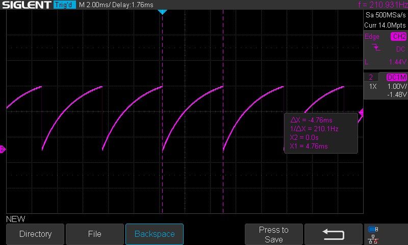

STM32F429ZIT6 STM32F429I-DISCO MB1075 B-01cycle NRST _ HELP. This is the NRST waveform.

board STM32F429I-DISCO MB1075 B-01.The demo example works great. When generating a project in the CUBE_MX 6.8.0,pack 1.27.1 , a soft reset is raised cycle.I do not know what to do

Positive the project is empty? No peripherals or GPIO defined? What clock source do you have selected? If HSE do you have the correct crystal frequency? No watchdog enabled? Read back the option bytes from the DISCO board.
BKond.1
Associate II
from the periphery only GPIO. the SFTRSTF flag is constantly raised.
But a few lines on CMSIS work fine. after CUBE_MX, a permanent SFTRSTF. :sleepy_face:
