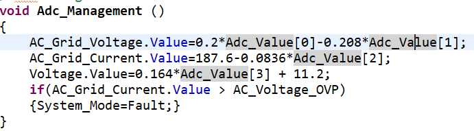

It takes 6.3us to finish the calculation in Fig.1. (I set a GPIO pin high before the calculation starts and set it to low after the calculation). ADC_Value[] is integer and the rest variables are float. The speed is just too slow to believe.

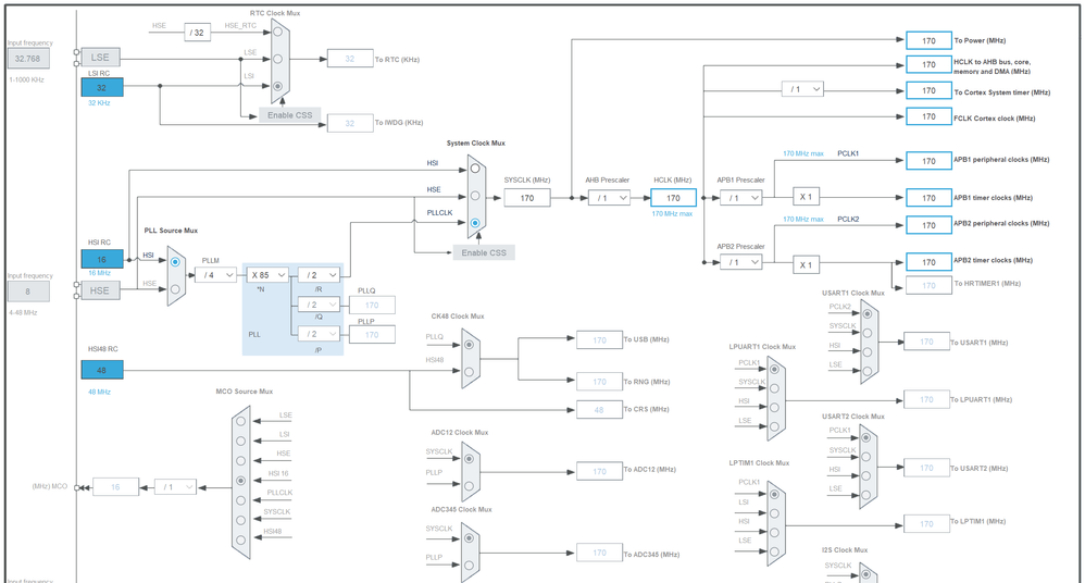

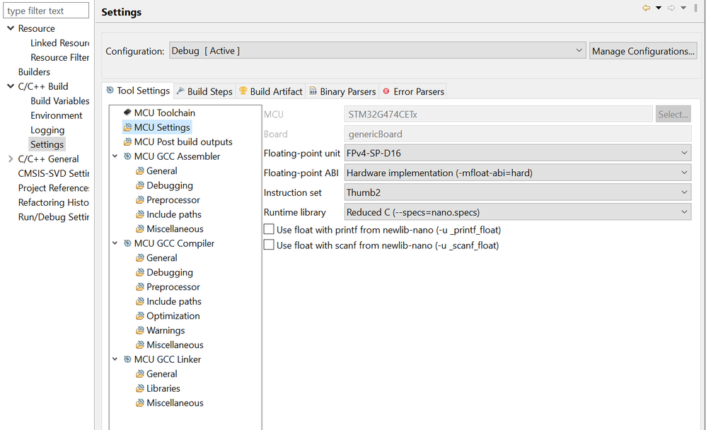

The clock is set to be 170MHz. Am I missing something in the project setting (shown in Fig2 and Fig3)? Is this the real calculation speed for the MCU?

Try to change ALL const value to float as said by Tesla...
For example use 0.2f instead of 0.2 (the Last one is a double !)
If the real app work on large buffer of adc value, consider loop unrolling coding optimisation instead of calling Adc_management() for each set of sample.

Otherwise, check your project settings, use of FPU vs sw emulated library, compiler optimisatipn mode, etc....

Check the generated code, check it's using float constants

Thanks for the example. I changed all the numbers to float format and used the -Ofast optimizer in the GCC Compiler Optimization setting. The calculation time length is reduced by 85% -- a much reasonable number. Thanks!
