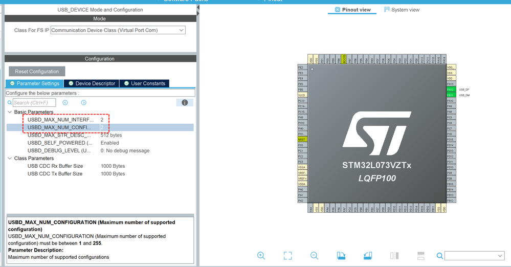

We are currently evaluating the STM32L073 series in terms of the possibility to configure the USB device as either:
In the STM32 studio I have noticed initially that in theory there is the possibility to define from 1 to 255 interfaces?
But then when set the USBD_MAX_NUM_CONFIGURATION and USBD_MAX_NUM_INTERFACES to 2, I had no way to configure more than 1 interface in the software GUI. I right now don't have the hardware to check that physically.
Are multiple USB interfaces possible for this one? I would appreciate all help.

2022-12-15 5:17 AM
What you want to implement is USB Composite Device. ST CubeMX and USB stack does not support composite devices yet, the work is in progress and you may try to study the HAL sources and maybe achieve what you want, since the stack itself is almost ready for it. The ST composite device will be even more complex than what we can see today with single function devices and I feel it will be very hard to use and debug with its infinite levels of nesting and callbacks. Feel warned that most of ST USB examples are incorrect and will at some point hang. There are few alternatives - much simpler and easier to use USB stacks available on the net.
I have implemented many CompDevs using a heavily modified (simplified) ST stack. Now I am in the process of switching to my much simpler stack with greatly reduced (by > 80%) ROM and RAM footprint - already working on F1 and F0 series (basically the same as L0), still some problems on L4/F4.
To see what's possible with a given MCU, count the endpoints required for your device. Control requires 1 ep pair, CDC - 2 pairs, MSC - 1 pair. There are 8 pairs available in L073, so you can do 3xCDC+MSC.
