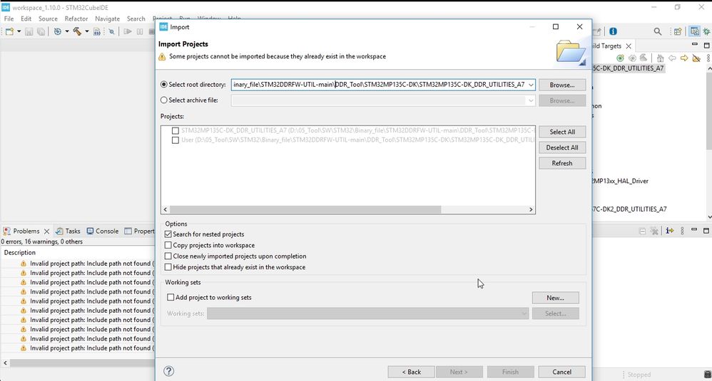

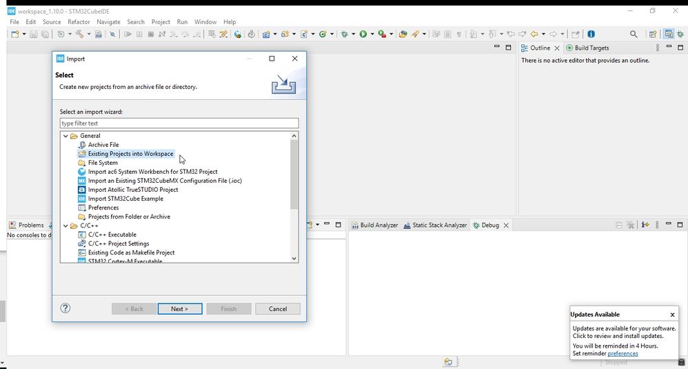

The the listed projects are gray and cannot be selected. "Finish" can not be selected. Could you help?
Thank you
2022-11-08 11:27 PM
2022-11-08 11:54 PM

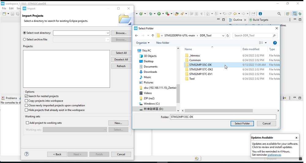

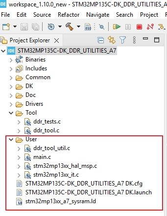

Helle @porter.chen
First sorry for my late response.
To be able to import correctly the project, you have to select the folder containing the ".project" file.
In you case you go another level lower to select the folder "STM32MP135C-DK_DDR_UTILITIES_A7"
Doing this will let you import the project successfully.

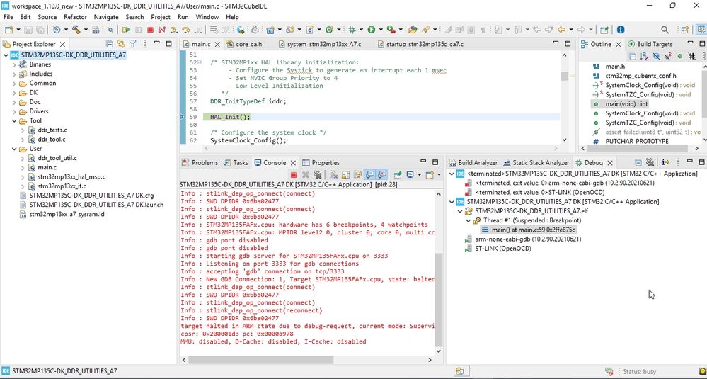

"This Port Com Is Not Responding" is still happened. Could you help?
The details are listed below.

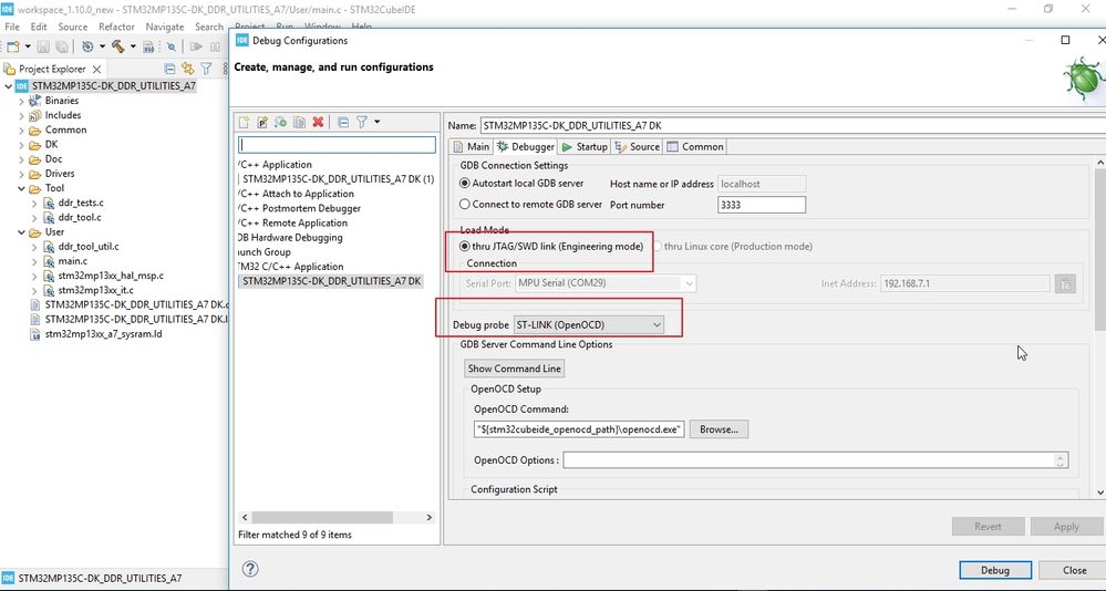

the main operation is to achieve(2.3.2 Using STM32CubeMX
After choosing another workspace location and restarting the import process, the files were successfully imported.
=> Shows a lot red info; gdb port disable
Red info:
Open On-Chip Debugger 0.11.0+dev-00449-g53fa0f7 (2022-06-09-09:42) [https://github.com/STMicroelectronics/OpenOCD]
Licensed under GNU GPL v2
For bug reports, read
http://openocd.org/doc/doxygen/bugs.html
srst_only srst_pulls_trst srst_gates_jtag srst_open_drain connect_deassert_srst
Info : Listening on port 6666 for tcl connections
Info : Listening on port 4444 for telnet connections
Info : STLINK V3J10M3B5S1 (API v3) VID:PID 0483:3753
Info : Target voltage: 3.306809
Info : Unable to match requested speed 5000 kHz, using 3300 kHz
Info : clock speed 3300 kHz
Info : stlink_dap_op_connect(connect)
Info : SWD DPIDR 0x6ba02477
Info : STM32MP135FAFx.cpu: hardware has 6 breakpoints, 4 watchpoints
Info : STM32MP135FAFx.cpu: MPIDR level2 0, cluster 0, core 0, multi core, no SMT
Info : gdb port disabled
Info : starting gdb server for STM32MP135FAFx.cpu on 3333
Info : Listening on port 3333 for gdb connections
Info : accepting 'gdb' connection on tcp/3333
Info : New GDB Connection: 1, Target STM32MP135FAFx.cpu, state: halted
Info : stlink_dap_op_connect(reconnect)
target halted in ARM state due to debug-request, current mode: Supervisor
cpsr: 0x200001d3 pc: 0x0000a978
MMU: disabled, D-Cache: disabled, I-Cache: disabled

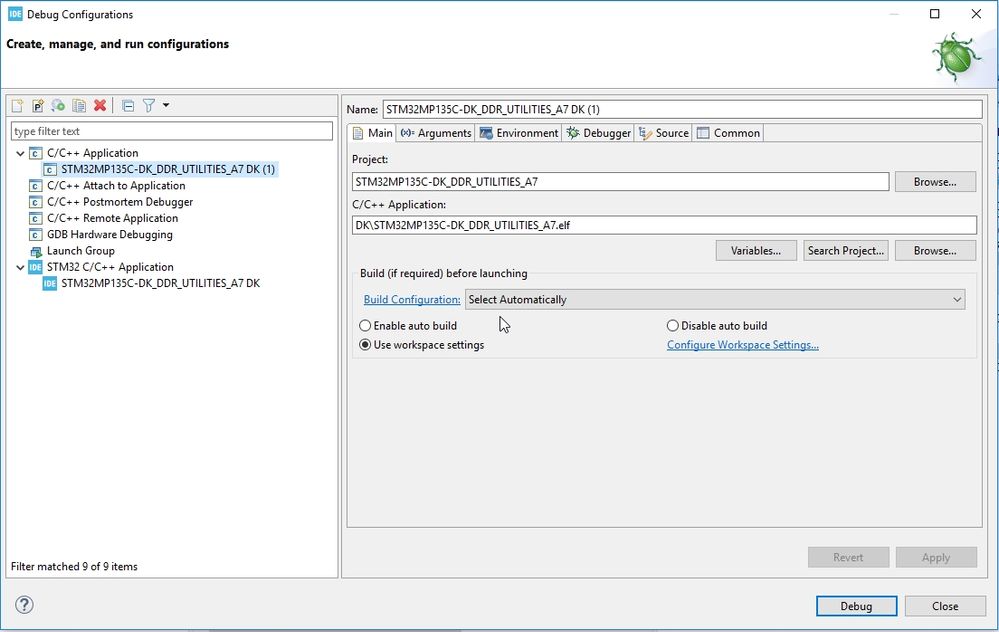

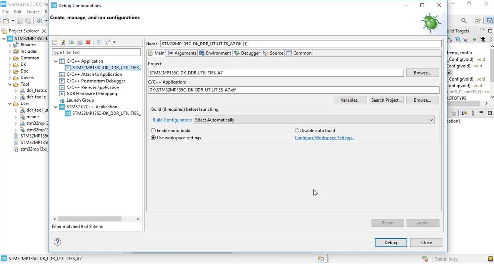

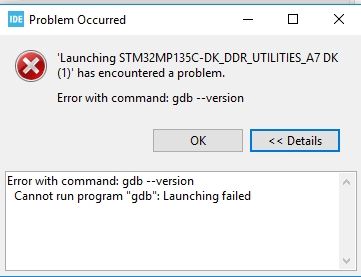

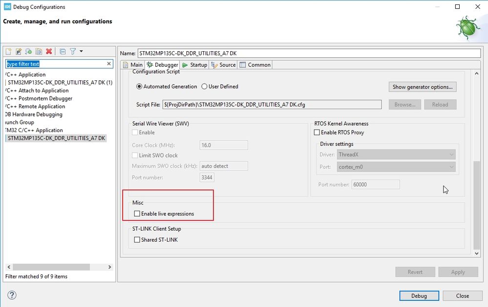

=>Error with command: gdb -- version
=>cannot run program "gdb": Launching failed

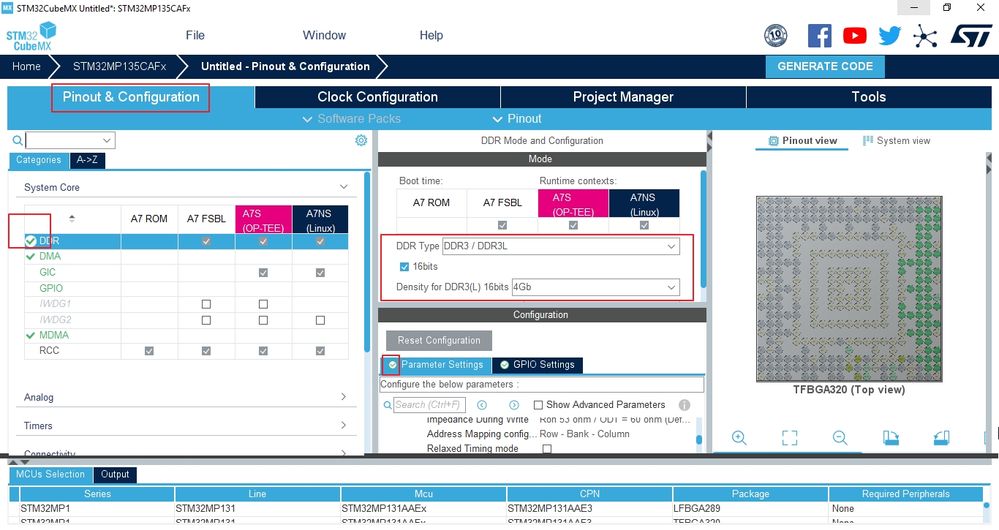

4.Open CubeMX and follow the steps described in 2.2
3.2.3 DDR configuration
Select the correct port com then connect the board. Target information is displayed when the tool is running properly
=> The Port Com is Not Responding
Thank you

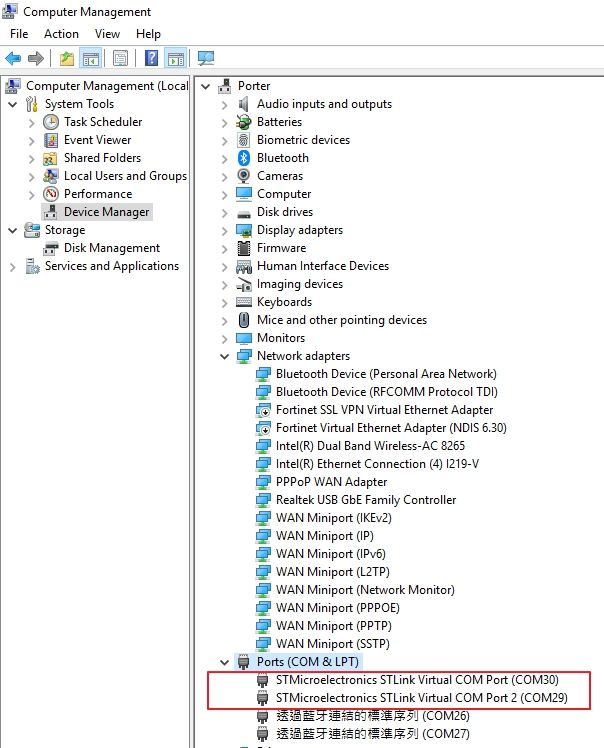

The connection of using DDR test suite is complete by using the operation steps listed below.
Please let me know if any steps need to be modified.
Flash the MP135 with the "STM32MP135C-DK_DDR_UTILITIES_A7_signed.stm32" file found under this https://github.com/STMicroelectronics/STM32DDRFW-UTIL/tree/main/Binaries/STM32MP135C-DK_DDR_UTILITIES_A7 with the Cube programmer in CLI using this cmd "Cubeprogrammer install path\STM32_Programmer_CLI.exe -c port=usb1 -w the file path\STM32MP157C-DK2_DDR_UTILITIES_A7_signed.stm32 0x01 --start 0x01"
=> download STM32MP135C-DK_DDR_UTILITIES_A7.stm32 to C:\Program Files\STMicroelectronics\STM32Cube\STM32CubeProgrammer\bin

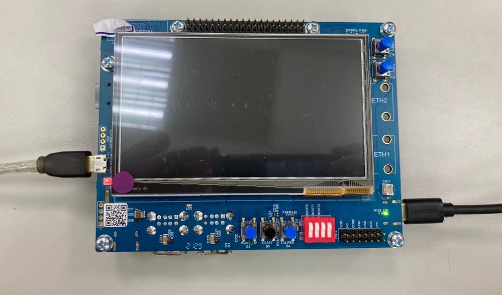

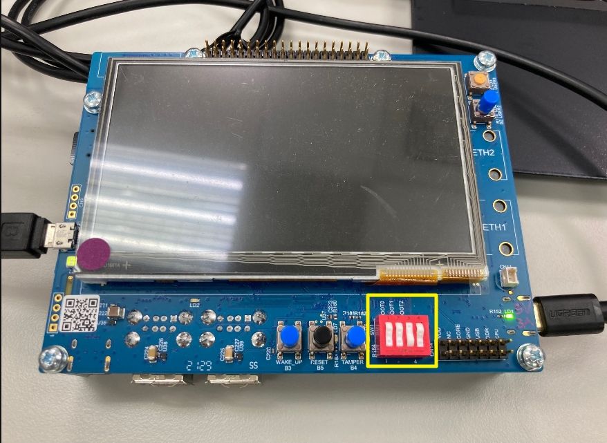

1 . connect cables as the picture shown below.(left: microUSB for ST-Link; right: USB typeC for power supply) the boot mode is set to "Force USB boot for flashing SW1[0 0 0 0]"

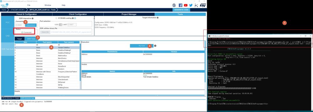

2 . open cmd, follow the below steps. (by referring to 3.1.3 SYSRAM loading from
https://github.com/STMicroelectronics/STM32DDRFW-UTIL/blob/main/README.md#11-package-overview or Hub - STMicroelectronics/STM32DDRFW-UTIL: DDRFW-UTIL tool repository) (the same)
in cmd: path in C:\Program Files\STMicroelectronics\STM32Cube\STM32CubeProgrammer\bin>
type in and run:
STM32_Programmer_CLI.exe -c port=COM30 -w STM32MP135C-DK_DDR_UTILITIES_A7_signed.stm32 0x01 –-start 0x01
then open STM32CubeMX, choose COM30 in DDR interactive, connect , run DDR test suite
