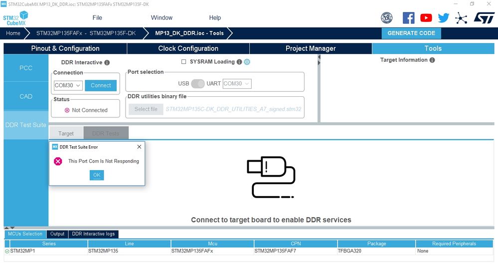

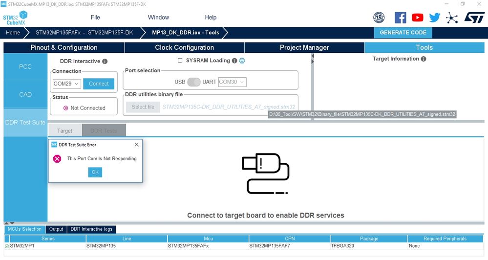

2022-08-04 3:13 AM

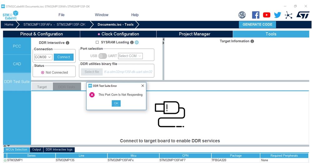

The board is installed with the system( stm32mp1-openstlinux-5.15-yocto-kirkstone-mp1-v22.06.15) by following the Getting started .
All drivers are installed.
However, in the DDR test suite, I cannot connect to the device.
How to make the right connection for using DDR Test Suite?
Do I need a DDR utilities binary file for the connection?
thank you

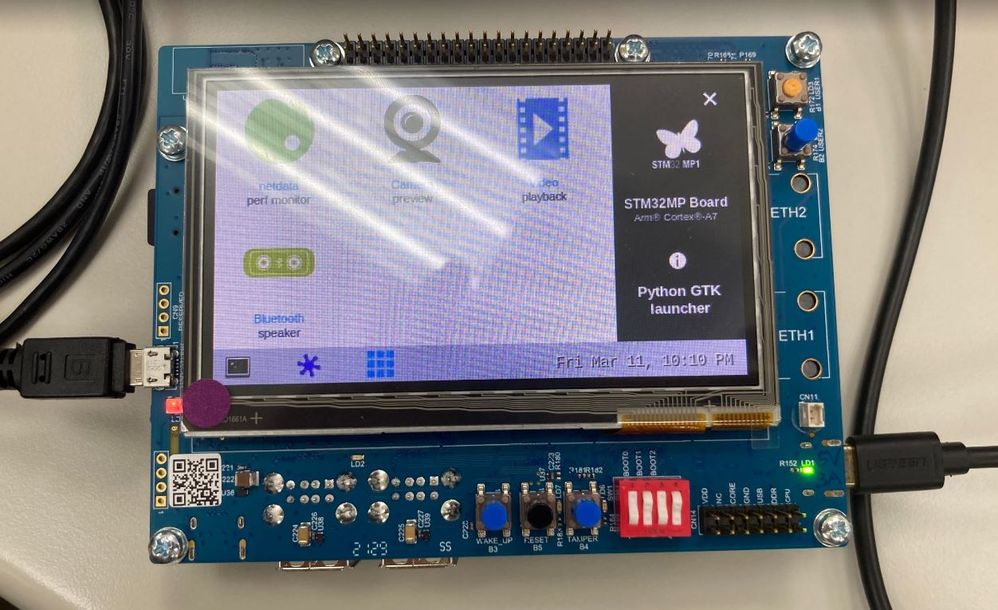

2022-08-11 8:44 PM
@Erwan SZYMANSKI (ST Employee) @Semer CHERNI (ST Employee)
Thank you for the support.

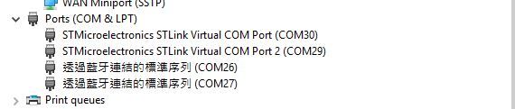

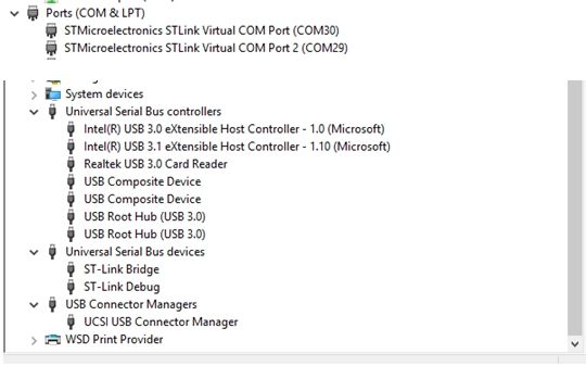

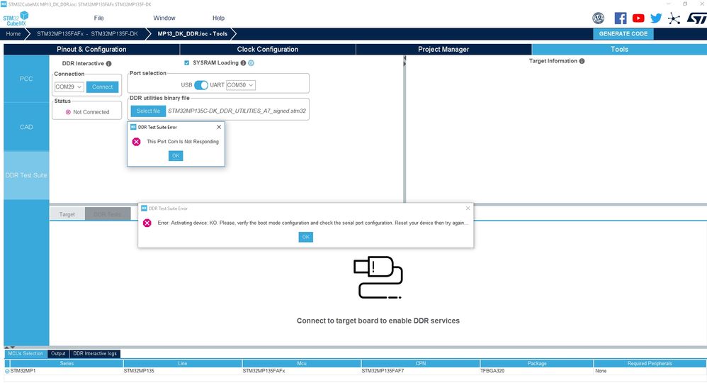

Then changed SW1 to [0010], [1010] and reboot, try to connect, but the same, it shows "This Port Com Is Not Responding".
Then I tried SW1 [0 0 1 0] and repeat "3.2.5.1.2 Serial boot"; and tried SW1[0 0 0 0] and repeat "3.2.5.1.2 Serial boot". It shows the same "This Port Com Is Not Responding" and "Error: Activating device: KO. Please, verify the boot mode configuration and check the serial port configuration. Reset your device then try again…"
Could you help?
Thank you
2022-08-11 8:54 PM
Adding the information I got from SW1 operating instruction
Force USB boot for flashing SW1[0 0 0 0]
Engineering boot SW1[0 0 1 0]
Boot from microSD card SW1[1 0 1 0]

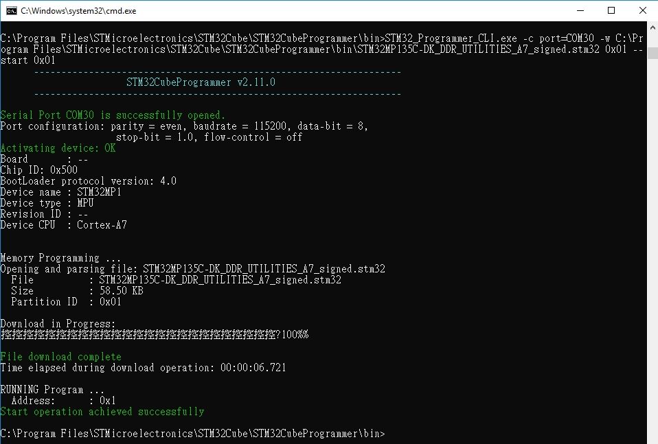

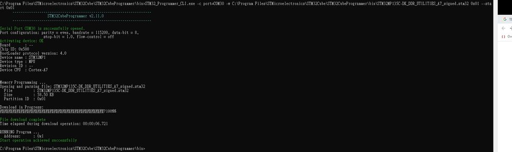

2022-08-26 10:21 AM
Hello @porter.chen
First sorry because my response took time.
About how to connect the board and run the DDR test Suite I found a roughly simple way:

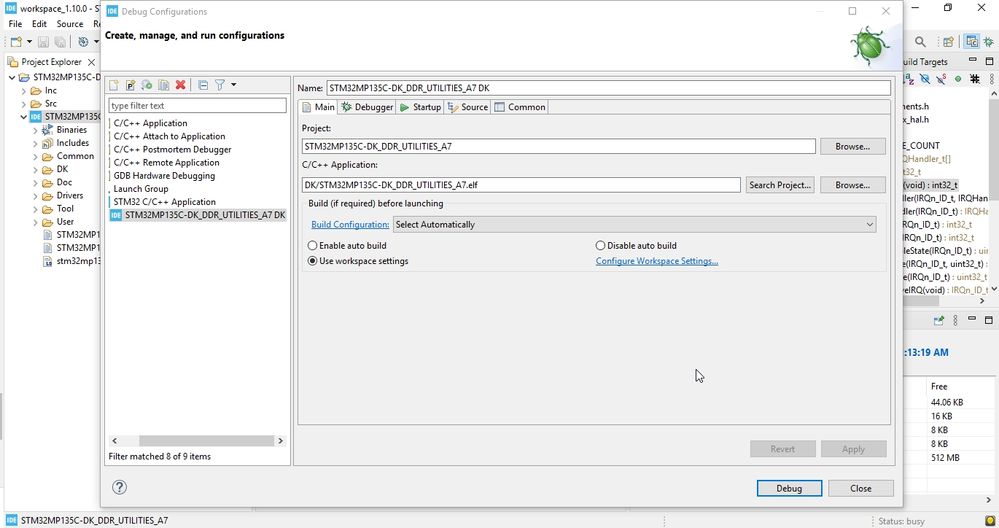

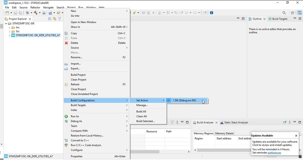

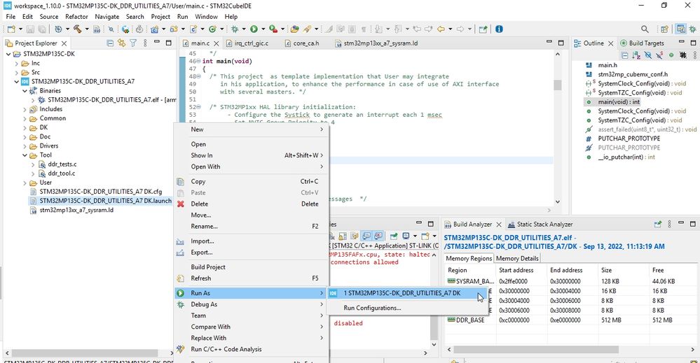

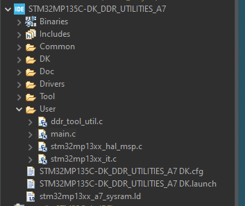

2.2.2 Build project
The project can contain several build configurations. In that case, you should firstly select the configuration corresponding to your hardware version:
To build the project in STM32CubeIDE:

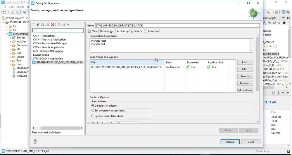

2.2.3 Launch project
To launch the project:

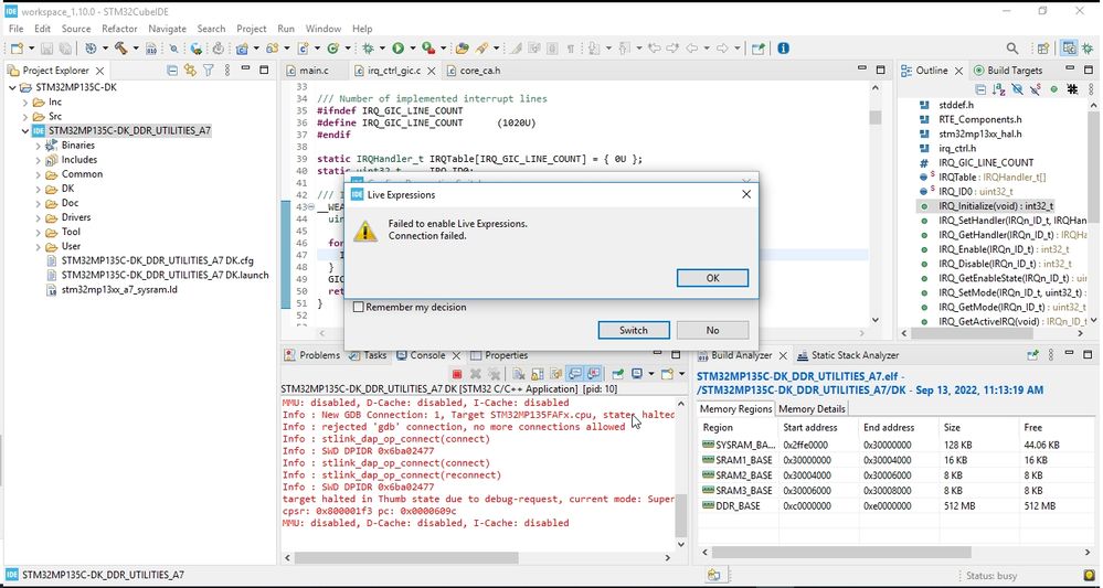

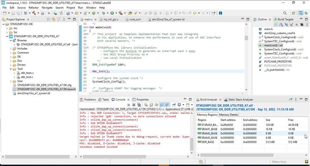

failure information:
Open On-Chip Debugger 0.11.0+dev-00449-g53fa0f7 (2022-06-09-09:42) [https://github.com/STMicroelectronics/OpenOCD]
Licensed under GNU GPL v2
For bug reports, read
http://openocd.org/doc/doxygen/bugs.html
srst_only srst_pulls_trst srst_gates_jtag srst_open_drain connect_deassert_srst
Info : Listening on port 6666 for tcl connections
Info : Listening on port 4444 for telnet connections
Info : STLINK V3J8M3B5S1 (API v3) VID:PID 0483:3753
Info : Target voltage: 3.310621
Info : Unable to match requested speed 5000 kHz, using 3300 kHz
Info : clock speed 3300 kHz
Info : stlink_dap_op_connect(connect)
Info : SWD DPIDR 0x6ba02477
Info : STM32MP135FAFx.cpu: hardware has 6 breakpoints, 4 watchpoints
Info : STM32MP135FAFx.cpu: MPIDR level2 0, cluster 0, core 0, multi core, no SMT
Info : gdb port disabled
Info : starting gdb server for STM32MP135FAFx.cpu on 3333
Info : Listening on port 3333 for gdb connections
Info : accepting 'gdb' connection on tcp/3333
Info : New GDB Connection: 1, Target STM32MP135FAFx.cpu, state: halted
Info : rejected 'gdb' connection, no more connections allowed
Info : stlink_dap_op_connect(reconnect)
target halted in ARM state due to debug-request, current mode: Supervisor
cpsr: 0x200001d3 pc: 0x0000a97c
MMU: disabled, D-Cache: disabled, I-Cache: disabled

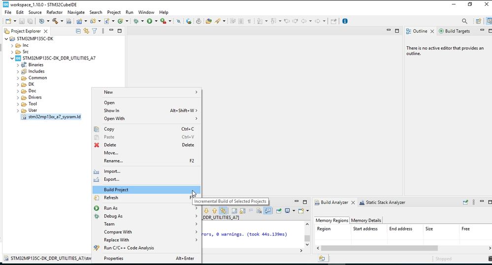

3.Build the imported project and run it
Info : Target voltage: 3.313828
target halted in Thumb state due to debug-request, current mode: Supervisor
cpsr: 0x200001f3 pc: 0x000060a4
shutdown command invoked

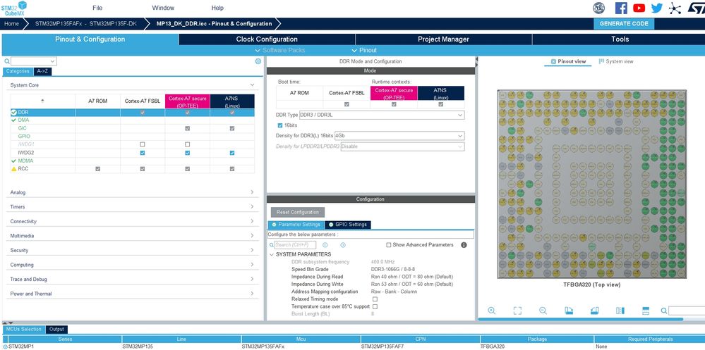

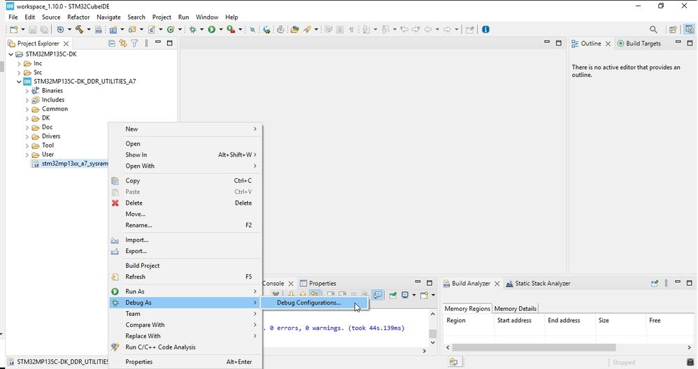

4.Open CubeMX and follow the steps described in 2.2 How to compile and launch DDR Tool project
=> The port com is not responding
Thank you

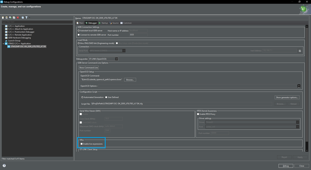

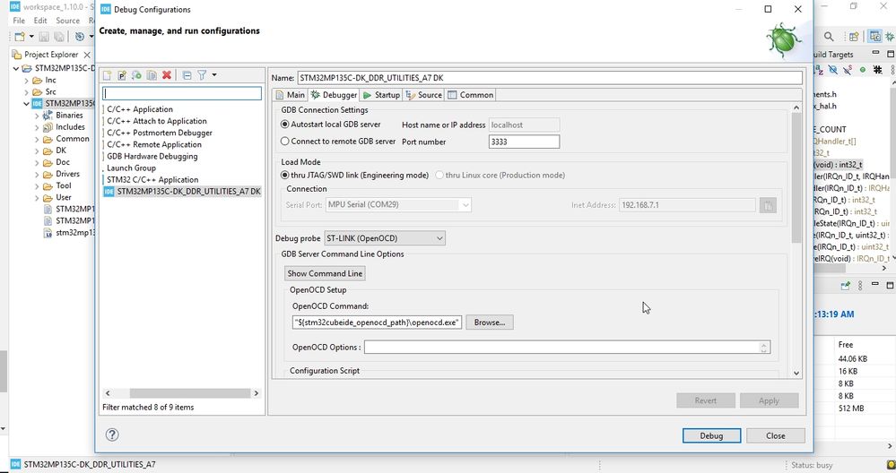

2022-09-13 2:28 AM
Hello @porter.chen
Thanks for your feedback.
I think that there are 2 main reasons for the failure:
==> Make sure you imported the project this way :
==> When the "Enable live expressions" is selected I get the same error message when debugging
==> Make sure that this option is disabled in the debug configuration
Kind regards,
