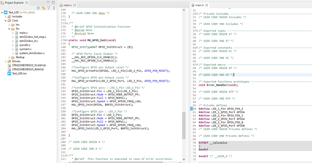

0693W00000JMdteQAD.pngCould you please repeat the process and share with us the results.

You are totally right, the issue is now confirmed. I had to refresh data to get the same results as you.
The user labels are generated correctly in main.h but they are not used in MX_GPIO_Init() function in main.c file. I submitted a ticket to the development team to fix this issue and I will keep you posted with the updates.
You can still use the user labels in your code since their definition is already done in main.h.
