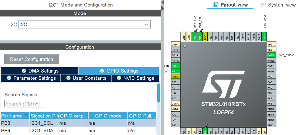

I am trying to use I2C on the STM32L010RBTX,
during configuration in MX, i realized that when PB8 and PB9 is configured as I2C, the GPIO mode field shows n/a.
And the I2C won't work as well.

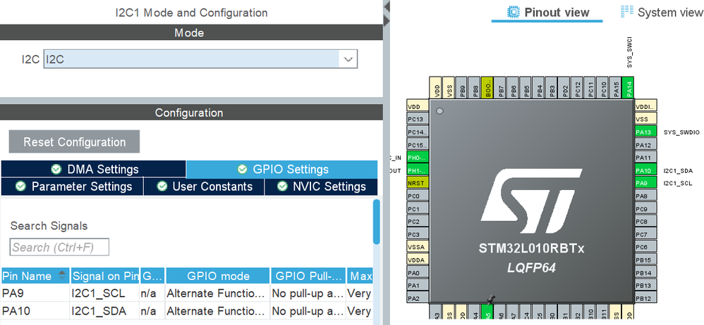

However, when i configure to PA9/PA10,
GPIO mode shows alternate function,
which, I2C works perfectly fine under the same code.

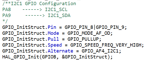

Look at the generated code to see if AF is specified. If not, you'll need to add that in manually in the I2C pin initialization code.
CubeMX has a bunch of bugs like this where it initializes the pins but with an uninitialized/zero AF field.

Pin initialization code is in HAL_I2C_MspInit in the stm32l0xx_hal_msp.c file.

You are right, it is indeed a CubeMX bug.
It seems that the GPIO configuration for I2C is missing from HAL_I2C_MspInit() when Port B is used.
It should be as follow:
void HAL_I2C_MspInit(I2C_HandleTypeDef* hi2c)
if(hi2c->Instance==I2C1)
/* USER CODE BEGIN I2C1_MspInit 0 */
/* USER CODE END I2C1_MspInit 0 */
__HAL_RCC_GPIOB_CLK_ENABLE();
/**I2C1 GPIO Configuration
PB8 ------> I2C1_SCL
PB9 ------> I2C1_SDA
GPIO_InitStruct.Pin = GPIO_PIN_8|GPIO_PIN_9;
GPIO_InitStruct.Mode = GPIO_MODE_AF_OD;
GPIO_InitStruct.Speed = GPIO_SPEED_FREQ_VERY_HIGH;
GPIO_InitStruct.Alternate = GPIO_AF6_I2C1;
/* Peripheral clock enable */
__HAL_RCC_I2C1_CLK_ENABLE();
/* USER CODE BEGIN I2C1_MspInit 1 */
/* USER CODE END I2C1_MspInit 1 */
}The missing part should be added in the user section, this will prevent loosing it when the code is regenerated by CubeMX.
/* USER CODE END I2C1_MspInit 0 */With this being said, the issue is now reported to the dev team to be fixed. I will keep you posted.
