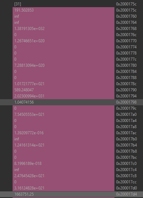

Hi @TDK2 . I show you in the next image, there are a few values in 0 and then in "inf" using these directions.
But if i use other array with other directions, everything works perfectly. I am lost in this problem.
Thank you so much
