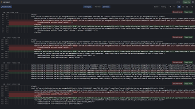

Here's the diff from .cproject file after regeneration.
UPD: found out it only happens if there are no libraries in the include list

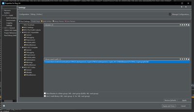

This config gets regenerated okay (from another project):
And this config gets library search path wiped on regeneration
I need the library search path to include extra linker scripts located elsewhere

I tried to reproduce your request. In fact, I have created a project using CubeMX v6.8.0 and CubeIDE 12.0.
Then I added the link of the library indicated in the screenshot.
I made the migration to CubeMX 6.9.2 and I generated the code to CubeIDE 13.2, but the problem is not reproduced and there is no loss of the library path.
