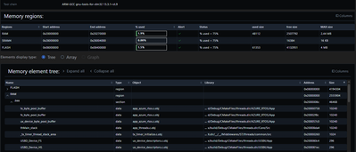

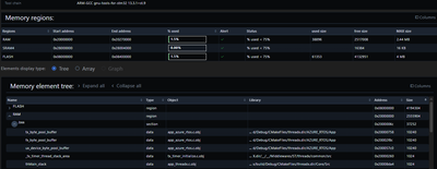

2025-10-21 5:52 AM - edited 2025-10-21 5:52 AM
Did you check Build Analyzer - Memory details ? Can you share? with small and large stack?
2025-10-21 6:01 AM - edited 2025-10-21 6:18 AM
With 10240 stack size
With 1024 stack size
The debugger "crash" at the line "previous_thread -> tx_thread_created_next = thread_ptr;" (line 258) in the "_tx_thread_create" function

Hi @PierreB
as a first view seems your heap and stack are too low in the script.ld file, please try with 0x1000 for both
2025-10-22 7:34 AM
Same problem with 0x1000. Moreover, the debugger works well (without the thread awareness) when I turn off the "serverRtos" parameter in the launch.json file
2025-10-23 12:08 AM
And if you increase heap and stack size in linker script file to 10240, is it working ok ?
10240 => 0x2800 for both
