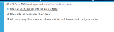

I am trying to integrate CMSIS-DSP in my CMake project. From CubeMX, I have the following options:

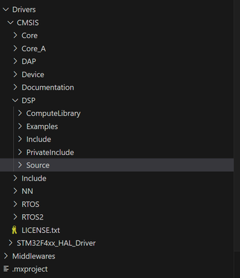

and I see the following folder struct:

However, while performing add_directory for DSP, I get the following error
[cmake] Build type: Debug
[cmake] CMake Error at Drivers/CMSIS/DSP/Source/CMakeLists.txt:12 (include):
[cmake] include could not find requested file:
[cmake]
[cmake] configLib
[cmake]
[cmake]
[cmake] CMake Error at Drivers/CMSIS/DSP/Source/BasicMathFunctions/CMakeLists.txt:5 (include):
[cmake]
[cmake] configLib
[cmake]
[cmake]
[cmake] CMake Error at Drivers/CMSIS/DSP/Source/BasicMathFunctions/CMakeLists.txt:6 (include):
[cmake]
[cmake] configDsp
[cmake]
[cmake]
[cmake] CMake Error at Drivers/CMSIS/DSP/Source/BasicMathFunctions/CMakeLists.txt:34 (configLib):
[cmake] Unknown CMake command "configLib".
[cmake]
[cmake]
[cmake] -- Configuring incomplete, errors occurred!
[proc] The command: "C:\Program Files\CMake\bin\cmake.EXE" -DCMAKE_BUILD_TYPE=Debug Question is, am I configuring anything wrong in CubeMX? From where should I bring configDSP and configLib?

Another approach I've had luck with is to add the CMSIS-DSP packs as software packs (CMSIS-Pack) in STM32CubeMX. Here are the directions:
I'm using the CMake toolchain IDE instead of STM32CubeIDE because of its excellent integration with JetBrains CLion.
Tested with CubeMX v 6.16.0.
