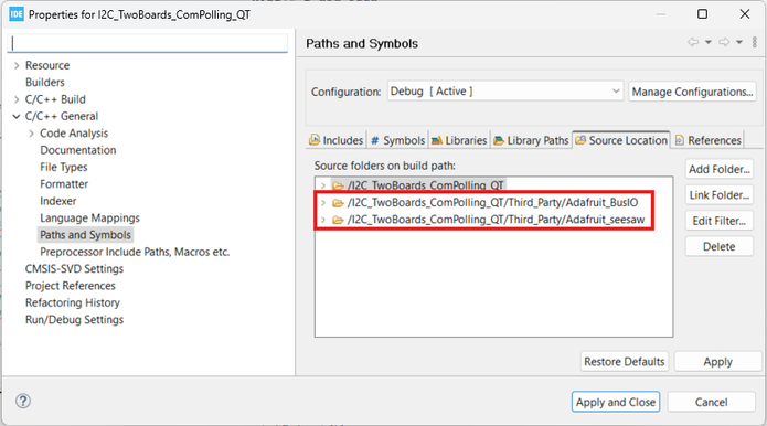

  • Added both the Adafruit seesaw and BusIO libraries (C++ code) to the project,
  • Updated the Project Include paths,
  • Added the library paths to the Project Source Locations (Figure 1), and
  • Renamed the main.c file to main.cpp.
Problem: the project does not built the Adafruit libraries, the compiler just ignores them.
What is the solution for this? How do I build the entire project, including the Adafruit libraries? Thank you!!!
Figure 1.

The solution is to convert the STM32CubeIDE project from a C to a C++ project. In the Solution Explorer right-click the project and select "Convert to C++".  I wrongly assumed that renaming the main.c to main.cpp is sufficient, but it is not.
