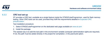

1.I am unable to found the CRC tool in STM32cube programmer which is given in UM3252. Where can i found the CRC tool?

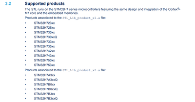

2.I have added and compiled successfully the SRC an INC to my project from given firmware ...Middleware\ST\STM32_Safety_STL. When i add linker file "STL_Lib_product_x1.a " to my project in MCU GCC Linker/Libraries in STM32cube IDE. Where ,which and how can i add the the object file located in LIB folder from ...Middleware\ST\STM32_Safety_STL?

1- You should download STM32CubeProgrammer. You can find it under this link STM32CubeProg - STM32CubeProgrammer software for all STM32 - STMicroelectronics. This step is described here
and the CLI to use is described here:
2- A way to do it in STM32CubeIDE should be through "Project properties>C/C++ build>Settings>Tool Settings>MCU GCC linker>Libraries>add". Make sure you add the correct library for your device following this recommendation:
Hope you find this helpful.

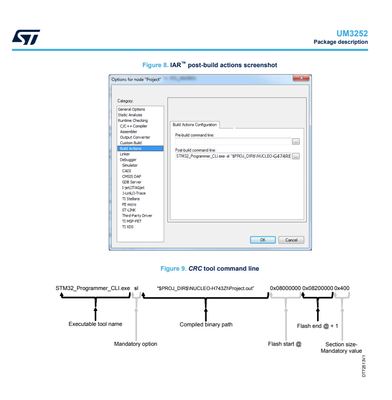

2.I have downloaded STM32CubeProgrammer v2.19.0. I am unable to understand the "6.2.2 CRC tool set-up" given by you(above picture) in figure8 IAR post build actions screenshot relation to STM32cube IDE. Where can i found the above screen sheet i.e is it part of STM32cube IDE or it is in separate application?

Hello, for the post-build command for STM32CubeIDE projects, please refer to the included example project for STM32CubeIDE. You will find the post-build-command configuration in STM32CubeIDE in Project->Settings->C/C++ Build->Settings->Build Steps.
As explained in the "CRC tool set-up" chapter in the UM3252, it will only work if your OS $PATH variable contains the path to the STM32CubeProgrammer, or rather the directory containing the STM32_Programmer_CLI executable.
If that is not your case, you will need to change the command to explicitly call the STM32_Programmer_CLI executable by its full path (eg. /full/path/to/stm32cubeprogrammer/bin/STM32_Programmer_CLI.exe instead of just STM32_Programmer_CLI.exe.
There is also version of STM32_Programmer_CLI packaged within the STM32CubeIDE installation. You can call it by using the STM32CubeIDE's internal environment variable $cubeide_cubeprogrammer_path.
The simplified command to call the packaged executable would then e.g. be:
${cubeide_cubeprogrammer_path}/STM32_Programmer_CLI.exe -sl ${CWD}/${BuildArtifactFileName} 0x08000000 0x08010000 0x400
