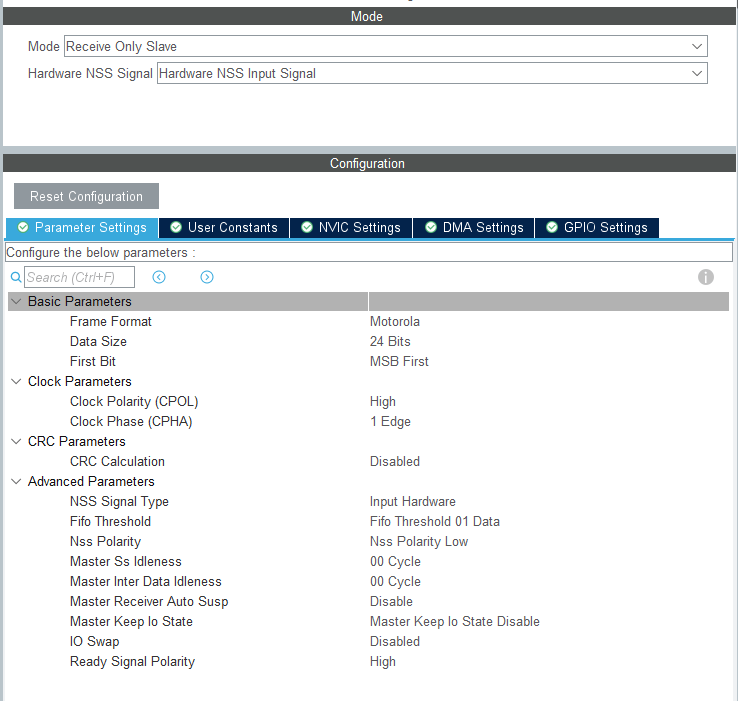

I'm using a STM32H523CC to receive 24 bit data frames via SPI. The SPI acts as receiver-only and is configured as follows:
Within my application I do not make use of the HAL-functions but have overwritten the SPI2_IRQHandler(). There I continuously read the data from the SPI RXDR register as soon as the SPI_FLAG_RXP is set. When some overflow/error-flags are set, they are cleared:

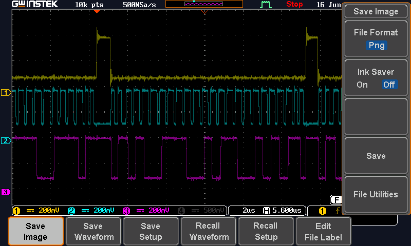

Update: this is what my SPI data transfers look like
Until now I could not find out what specific situation causes the SPI receiver getting out of sync...
2025-06-16 5:56 AM - edited 2025-06-16 5:56 AM
I'm still of the opinion that NSS synchronizes the stream. You provide no evidence for it getting out of sync.
If it does behave as you say, it should be easy to reproduce the behavior in self-contained program at much lower clock rates and capture the signal on a scope.
