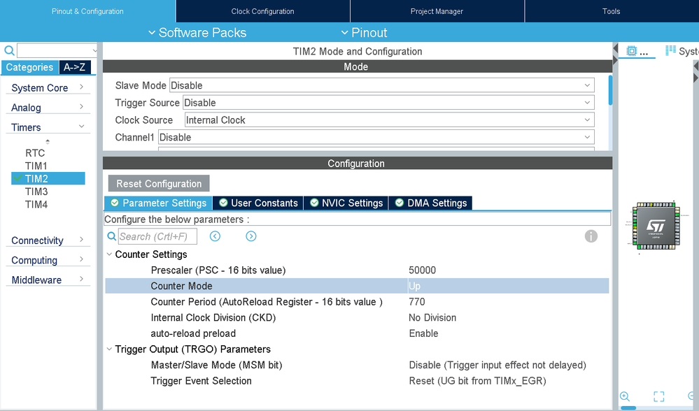

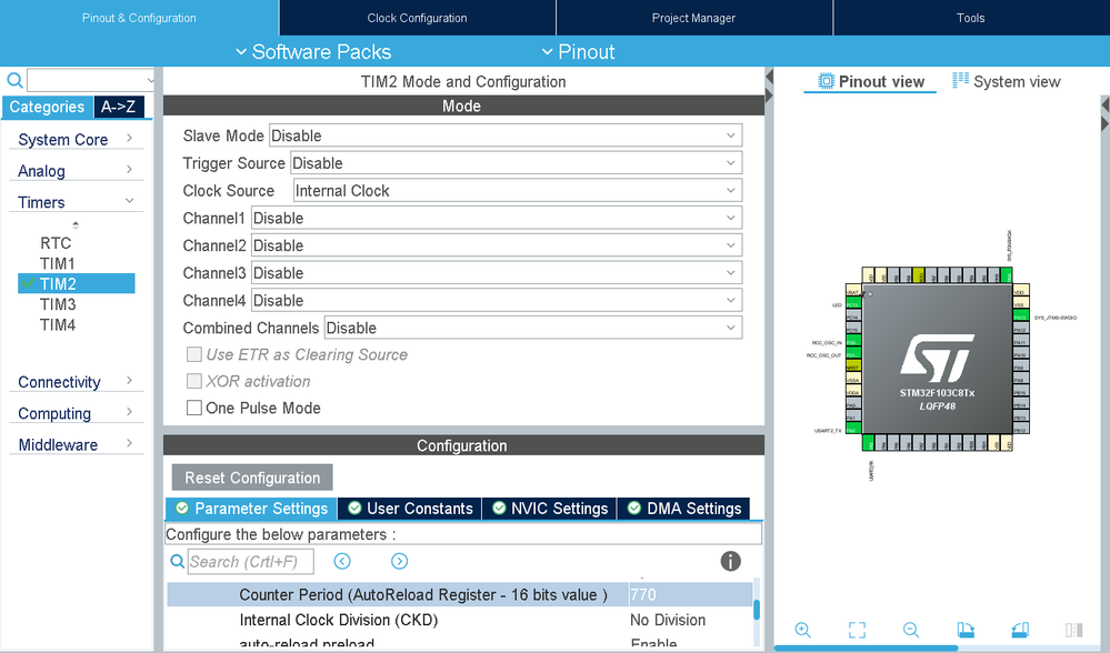

Here are the two MX TIM2 configuration screen shots:
(I hope you see the full-size images and not the tumbnails I see.) This message editor's file-attachment button is grayed-out!)

The LED output pin really is C13, not A13 on the BluePill board (STM32F103C8T6). I've already made the LED turn on and off, so that's not it. Timer interrupts are simply not being generated using STM32CubeMX-generated code, else the callback function would have been called. I'm absolutely sure it's never called.

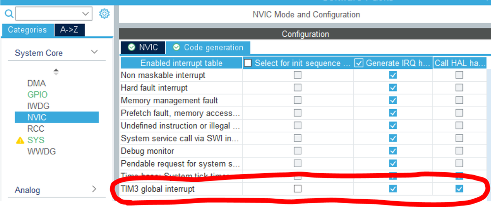

The cause is really simple: the Cube-generated code has no call to HAL_TIM_IRQHandler !
I'll try switching micros to see where it's supposed to be.
2021-01-10 9:22 AM
The call would be in stm32f1xx_it.c.
There is a checkbox in CubeMX to enable this, in NVIC settings. And another checkbox to call HAL_TIM_IRQHandler within it.
Same setting is under the timer NVIC configuration as well.
