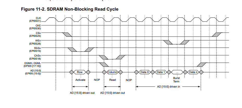

That's informative, thank you. I'm coming from a TIVA project where we shared the Address and Data pins on the MCU so that the total pin connections was 32 (for 16bit data). The exchanges first programmed the address on the data lines and then the data itself, as shown here. What I think you're saying is that there is no way to mux the address and data pins, they are all needed in parallel. That would certainly require way more pins.

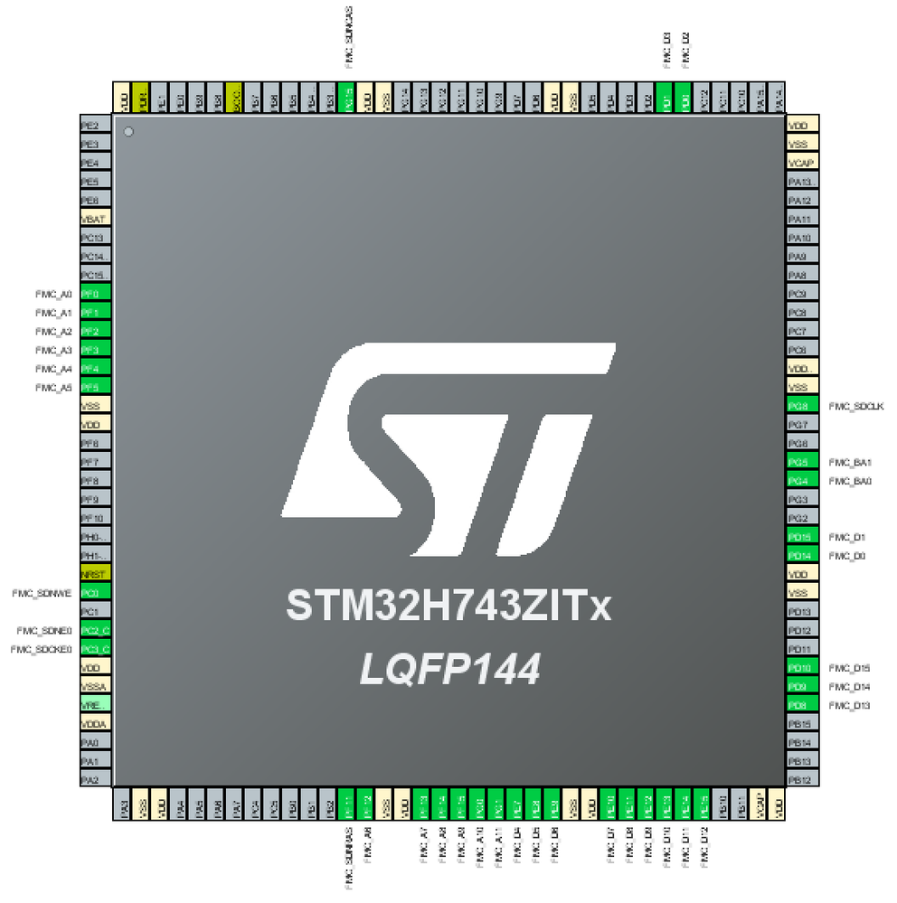

STM32CubeMX will happily do this for you.
Edit: I was using LQFP144, not LQFP100. There is no SDRAM configuration available on LQFP100.

As for the shared address/data scheme as you've outlined above (from the Tiva manual) - interesting concept, but I don't think the STM32 FMC module supports this, see SDRAM controller subchapter of FMC chapter of RM.
